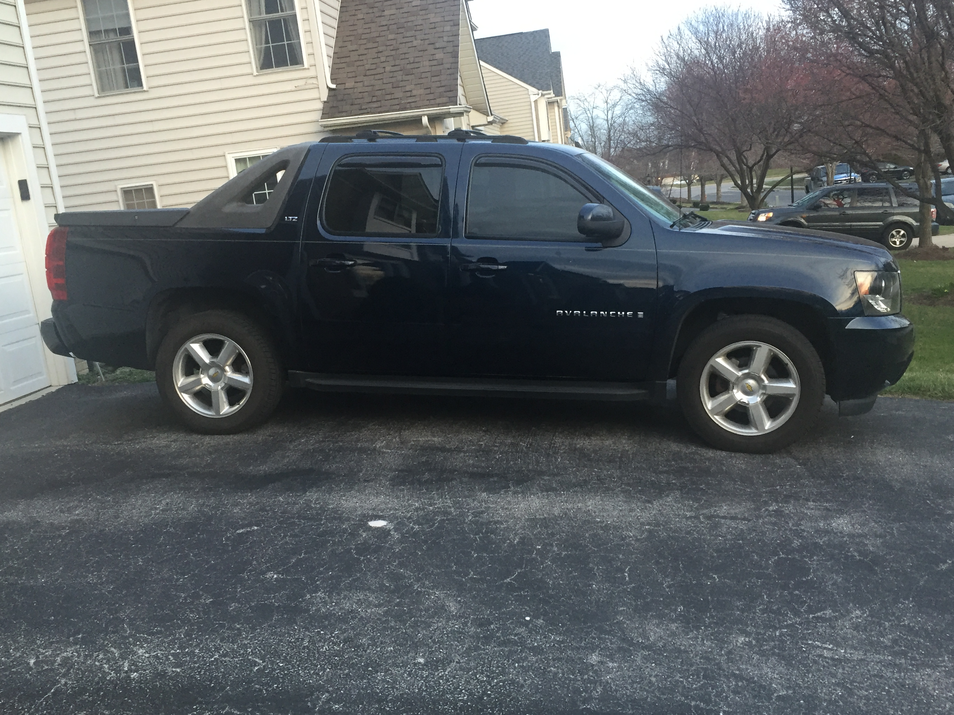

I'm new to the tuning game so I don't want to screw with too much until I understand what and why to adjust. I will try the Diablo tune next with the AFM off. Thanks
