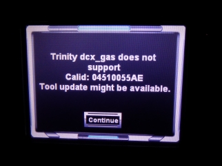

Updated to tool to crom 1r13i today and now it says it doesnt support my CalId 04510055AE. What is going on? This car is my only way to work and it will not run properly with the stock tune since it has a tune for 3 bar map and tip and RC 750cc Injectors. Please help! I have to work at 7am. :oops: :oops:

i had the same problem with mine with the Trinity_DCX_gas_1r13h.crom
The 1r13 mega crom works, the H amd I think I has bugs and who knows what their time frame is on fixing it. The mega crom should work just fine for you

The mega crom SHOULD work for you....i no longer use DS products for the sole reason on how the CS with their tech dept. when i called. Timeframe....take a number u got better odds of getting hit by lighting. :blowup:

I had the same problem. I found an update 1r13f instead and installed with it instead of 1r13h and it worked for me.
