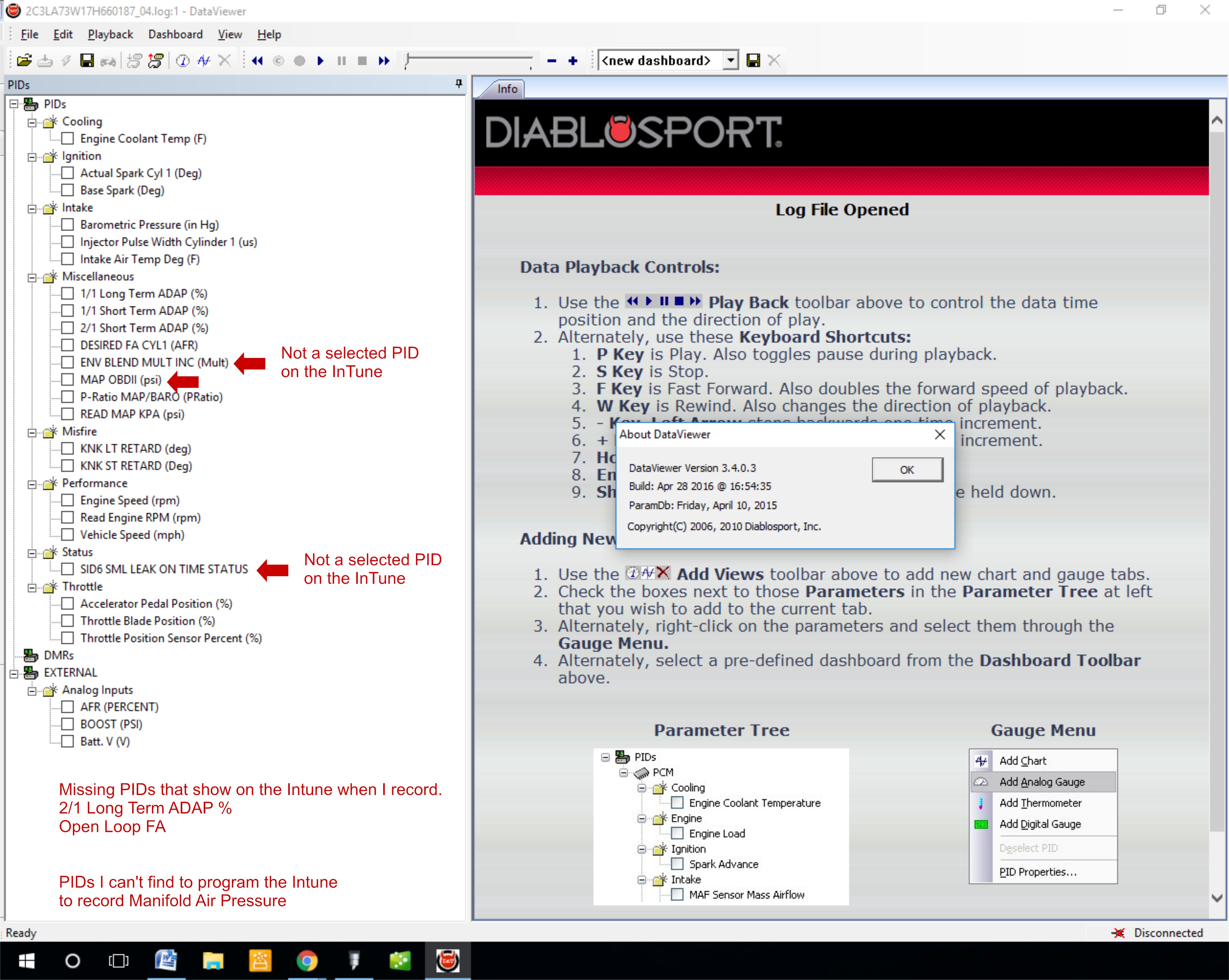

I'm beyond frustrated.
I just want to log the PIDs my tuner wants so I can get my car running properly.
The Problems
- I can't find a PID for my car that my tuner wants me to record (Ex. Manifold Air Pressure)
- When importing a log into dataviewer on the PC additional PIDs are shown
- PIDs are missing in the dataviewer that were showing on the Intune
I've set up all the correct PIDs in the Intune. When I Record it shows all the correct PIDs but when I bring it to my computer to view the logs some of the PIDs that were showing have been replaced, missing, and additional PIDs are now showing.
The run down of the equipment
Intune firmware 1r04j
Dataviewer Versoin 3.4.0.3 on Windows 10
Vehicle 2007 Chrysler 300 SRT8
I've attached a picture of what I'm seeing.
The Items I want to log on the intune and are selected with the exception of Manifold Air Pressure
Base Spark
Actual Spark Cyl 1
Intake Air Temp
Manifold Air Pressure (I can't find on the intune to be able to log it)
Barometric Pressure
Injector Pulse Width Cyl 1
1/1 Short Term ADAP
2/1 Short Term ADAP
1/1 Long Term ADAP
2/1 Long Term ADAP (Not showing up in Dataviewer)
Desired FA Cyl 1
Open Loop FA (Not showing up in Dataviewer)
Read MAP KPA
P-Ratio MAP/BARO
Knk LT Retard
KNK ST Retard
Vehicle Speed
Engine Speed
Read Engine Speed
Throttle Position Sensor
Accelerator Pedal Position
Throttle Blade Position
Now for PIDs that are showing up in the Dataviewer that I DO NOT have selected on the InTune.
ENV Blend Mult Inc
MAP OBDII
Hopefully this make since and someone can help me.
Screen Shot of Dataviewer with unwanted PIDS.jpg (1.22 MiB) Viewed 14932 times

If you could please post the log you're working with. Also MAP obd2 is manifold air pressure.

Exact same problem. Trying to log 05 Dodge Magnum. Log files will populate PIDs but the correct dashboard doesn't show what Johan needs. Using latest version. Getting pretty frustrated here too. Used to work perfectly.
