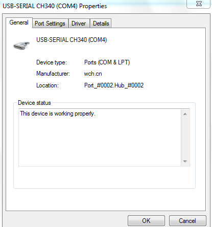

Here it is with the second cable I tried, the first one says the same thing.
- Capture3.PNG (19.46 KiB) Viewed 4754 times

Re: U7135 can't connect to win7 with USB serial cable
So one thing I didn't do is try the second cable I got a loan of, back onto my original Windows 10 machine. Did that, DS Downloader saw it right away and I was able to calibrate the tool and tune my car.
Thanks.
Thanks.
- Posts: 58670
odd, must have been some bad cables.
