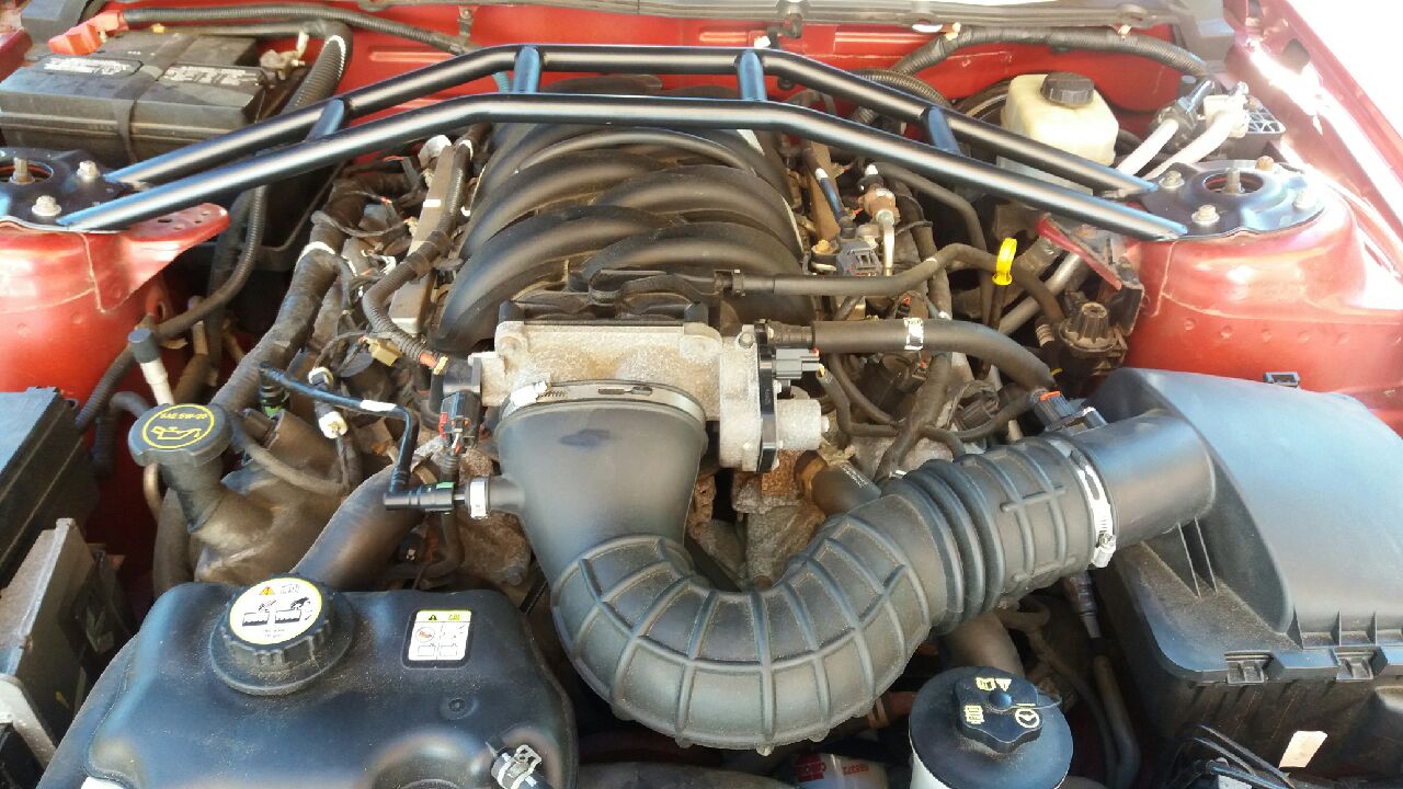

Hi,
I updated my Predator 7140 to V. 9r09
Which tune would I use for the JLT Series 3 CAI?
Thank you,
Frank

you'll want to load the 91 or 93 tune then post a copy of the last tune written here so we can modify it for the JLT S3.

I used to tell people that this car "screws", now I tell them that it's on steroids!
This car is really smooth shifting through the gears. It reaches the top of the RPM limit so much faster than it used to.
Sounds incredible, totally different than before. Like a totally different vehicle.
My son is really going to regret selling this to me now
Wooooooooooooooooooo!
