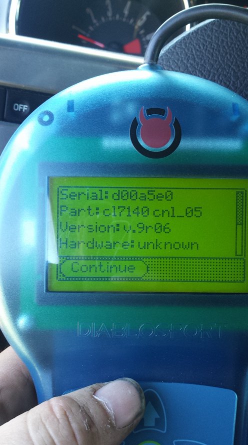

what is the software version on the top line of the main menu?
Tombstone997
Posts: 9
Joined: Wed Aug 17, 2016 12:41 pm
Re: Check Engine lights after Predator tune
Post by Tombstone997 »
Tombstone997
Posts: 9
even if i only modify the stock tune and try to turn up the fuel to air ratio a tiny bit to account for my cold air intake as soon as i takeoff the car acts funny then i get a check light for that same "unknown" code...

load the 87 street tune and post up the last tune written and the original backup out of the tool so i can take a look at it.

whats the software version on the top line of th emain menu of the tool?
Tombstone997
Posts: 9
im unable to connect my device to a PC, that was the main problem i cant update the tool because i can not connect it to the computer, when i plug it in nothing happens, it doesnt turn on and the computer wont even "see" it
