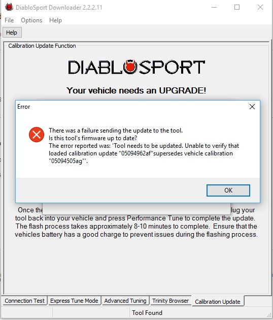

I got the following error while trying to perform a DCX update on a U7137 with 9r14. Is there a newer crom than 9r14 or is it because I was using an outdated version of DSDownloader? Did the update go through? I had a customer ship me their programmer just so I could do the update for them, will I need to send it back to them now to have them get the DCX update info on it and then have them send it back to me again?

you should update dsdl and try again:
http://installers.diablosport.com/softw ... .3.1.0.exe
