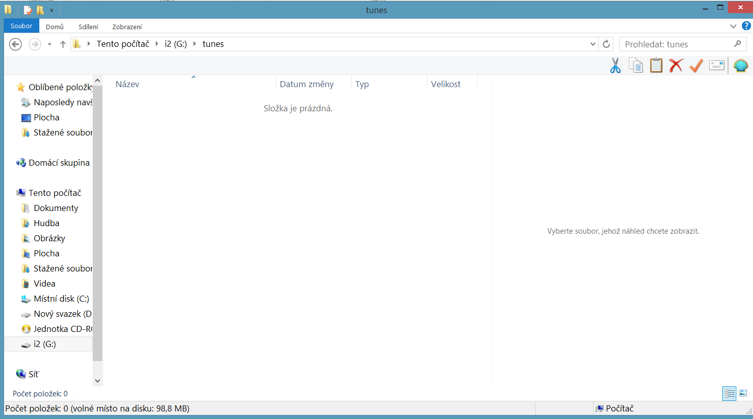

Re: Jeep GC 5.7L 2005 "not supported"
No, tunes folder is empty.
- more info
- diablo 2.jpg (237.2 KiB) Viewed 7791 times
- tunes folder
- 4.png (66.03 KiB) Viewed 7791 times
- device folder
- 3.png (75.35 KiB) Viewed 7791 times
