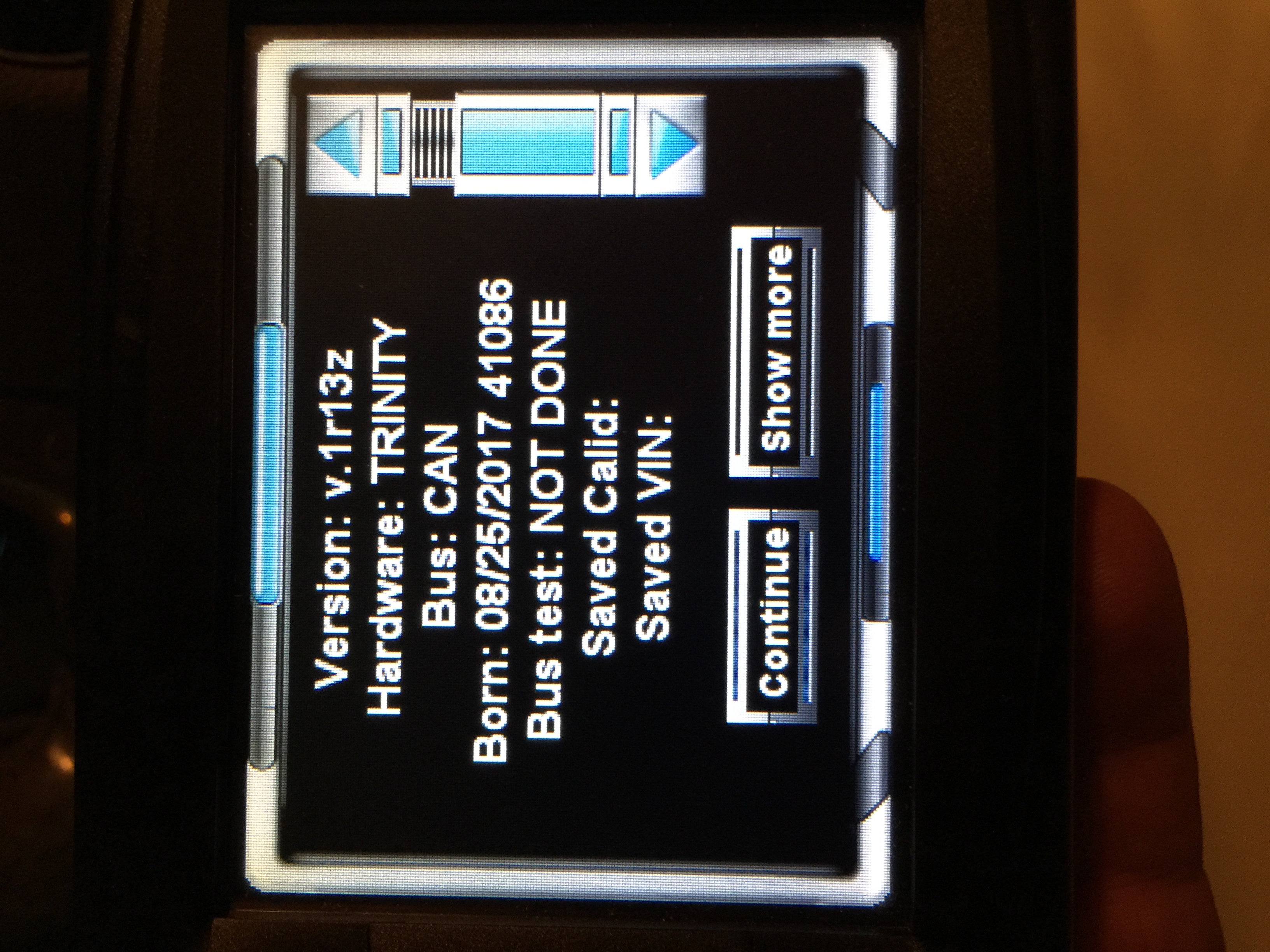

:lamer: I have a 2009 GMC yukon with 5.3L. I pay trinity make now update I got to performance and select automatic as my transmission, the trinity says my calibration is not supported and that I must export the backup file and call diablo sport. Need help
Here is a list of information from my trinity:
Serial: 6K2MX19-1
Part: gm_can_gas
Version: v.1r13z
Hardware: TRINITY
Bus: CAN
Saved VIN:1GKFC23J79R181094

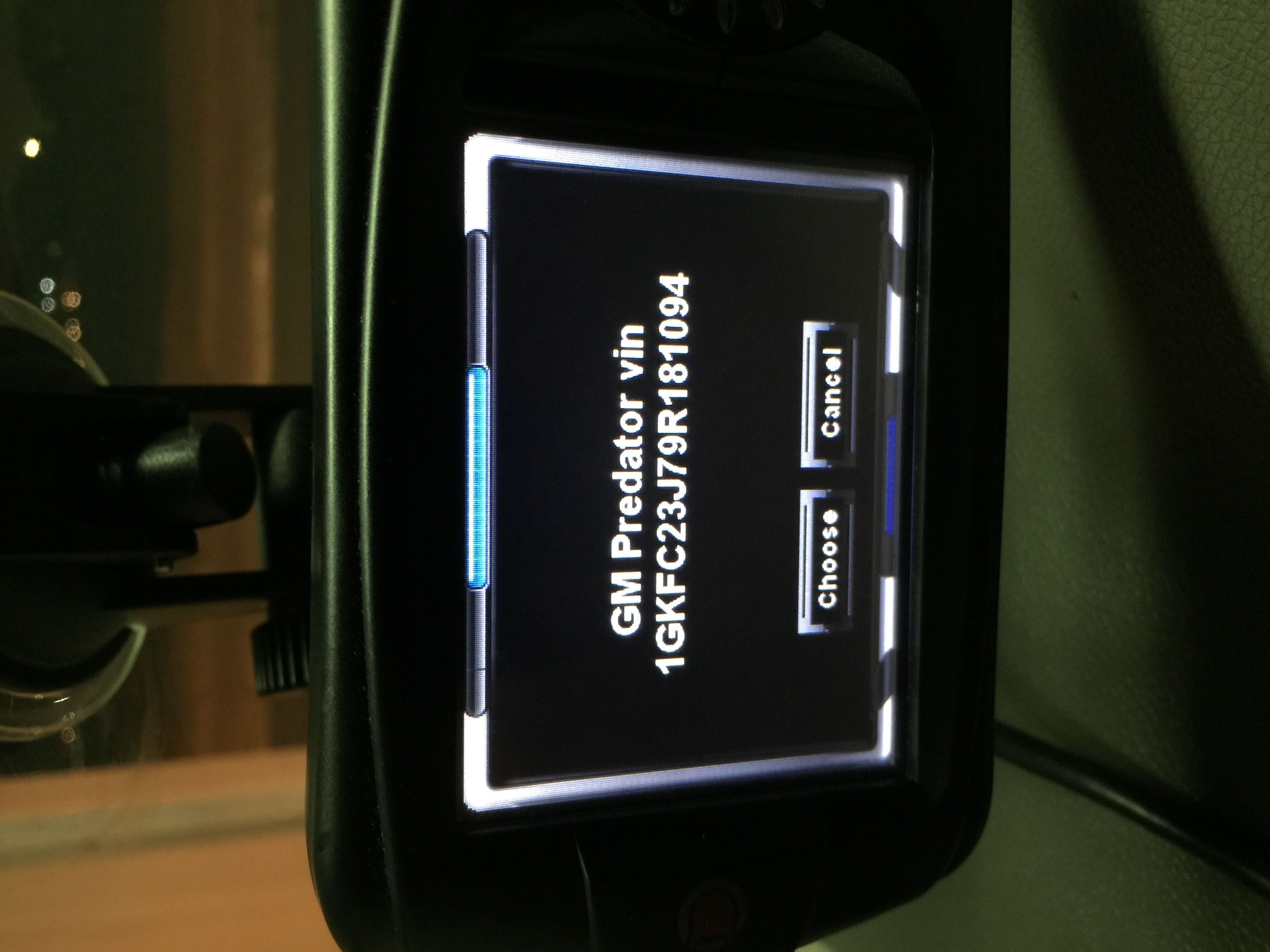

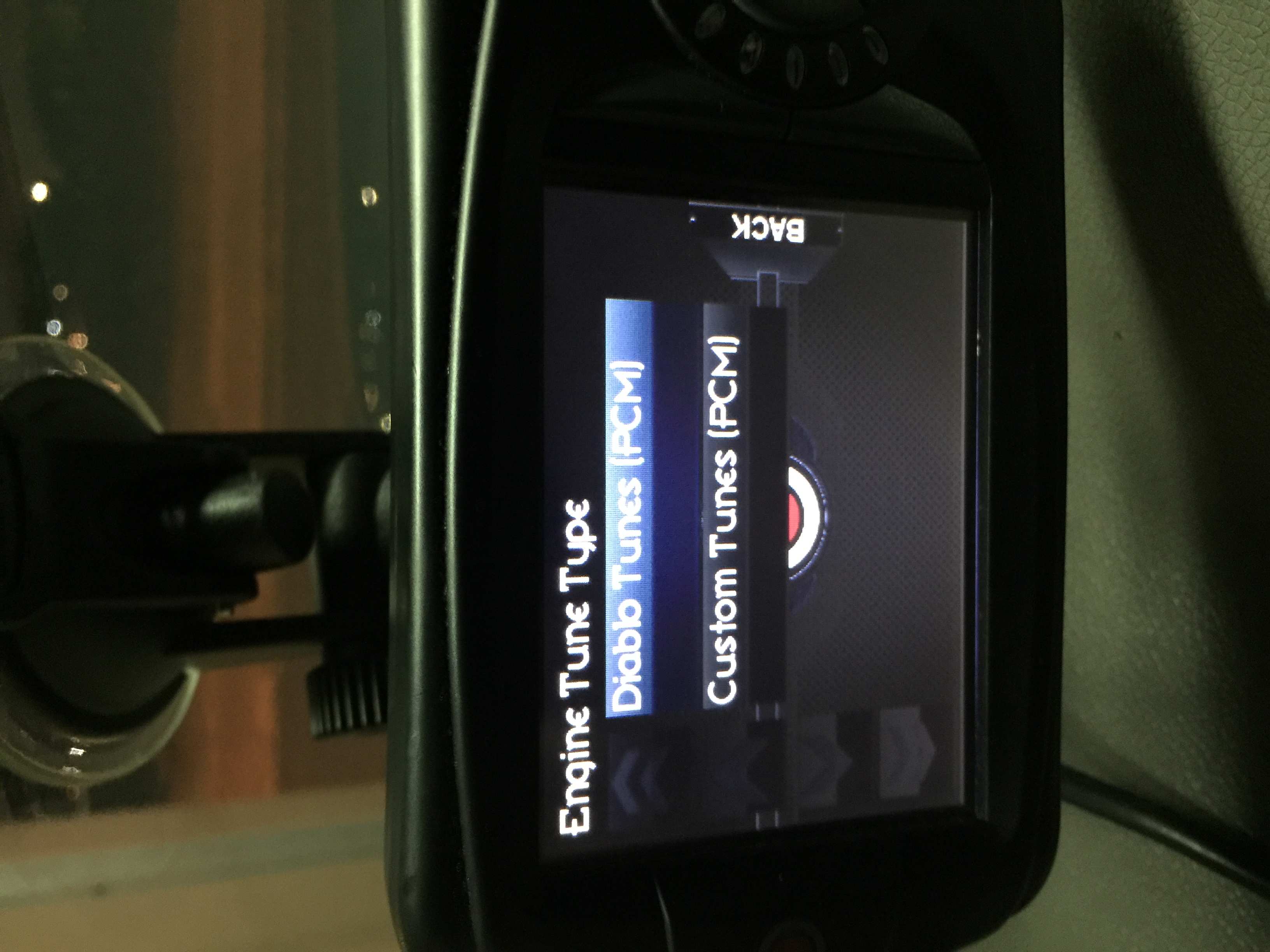

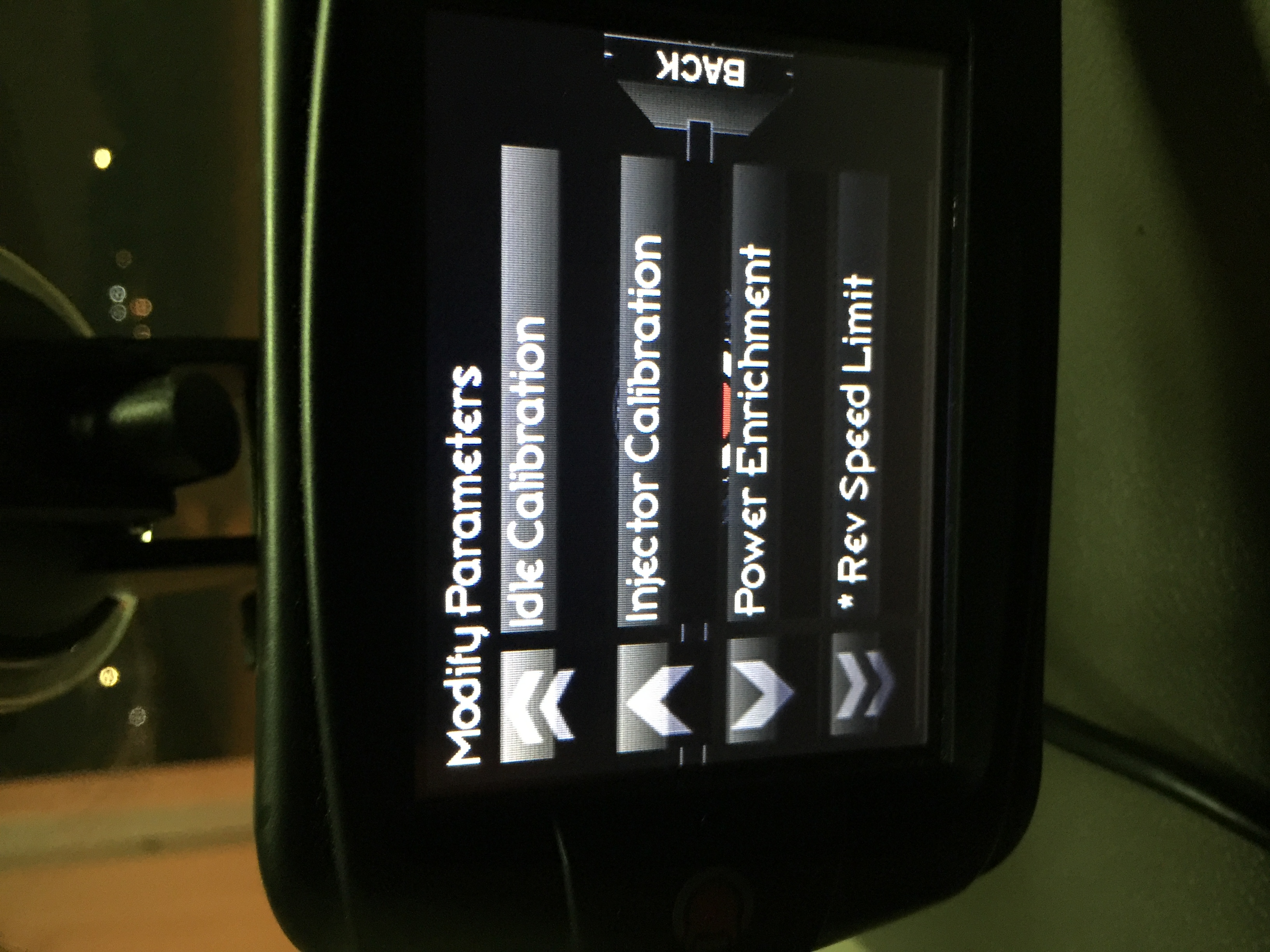

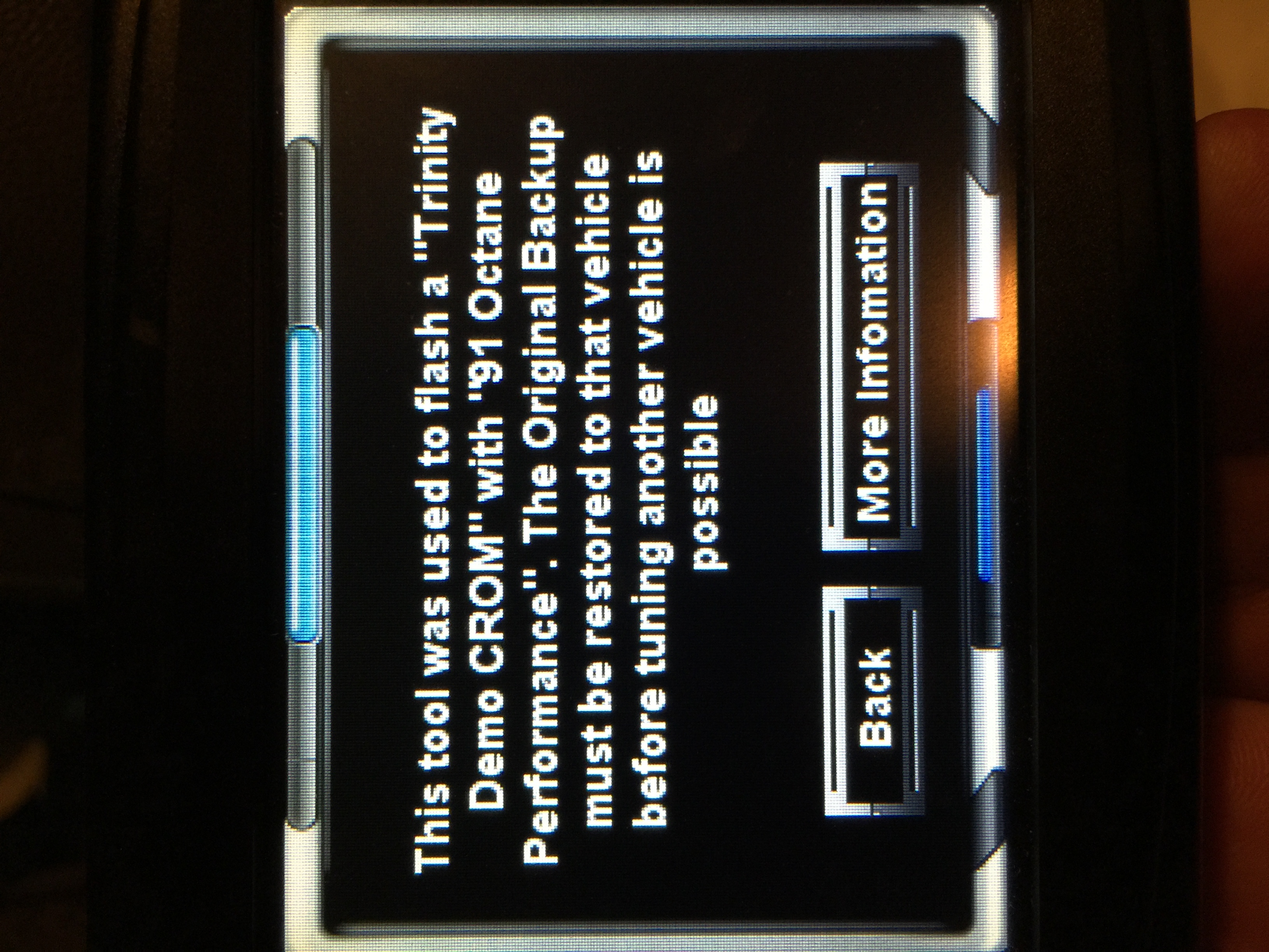

Sir today I use the device got me a problem and these pictures what you advise me to do now

Looks like you married it in demo mode.
Go to options./change vehicle and sleect demo and let it reboot.
then go to performance and select original backup, and let it restore.
then load the attached update using dsdownloader and then select your vehicle and you can tune it.
trinity_gm_can_gas-1t14ab_update.crom

Thank you very much for your efforts with me. I would like to inform you that the machine is now working very well but unfortunately there is some basic service in the machine is not available, for example1-additional custom tunes2-options in the tuning menu might be: 93 Octane Performance tune, 91 Octane Performance Tune,3-and I have problem with DoD this option not work well v8 -v4,4-Towing,Economy,Extreme
tune are not available in DiabloSp
castom tune
I hope you can review the file so you can see the problem
