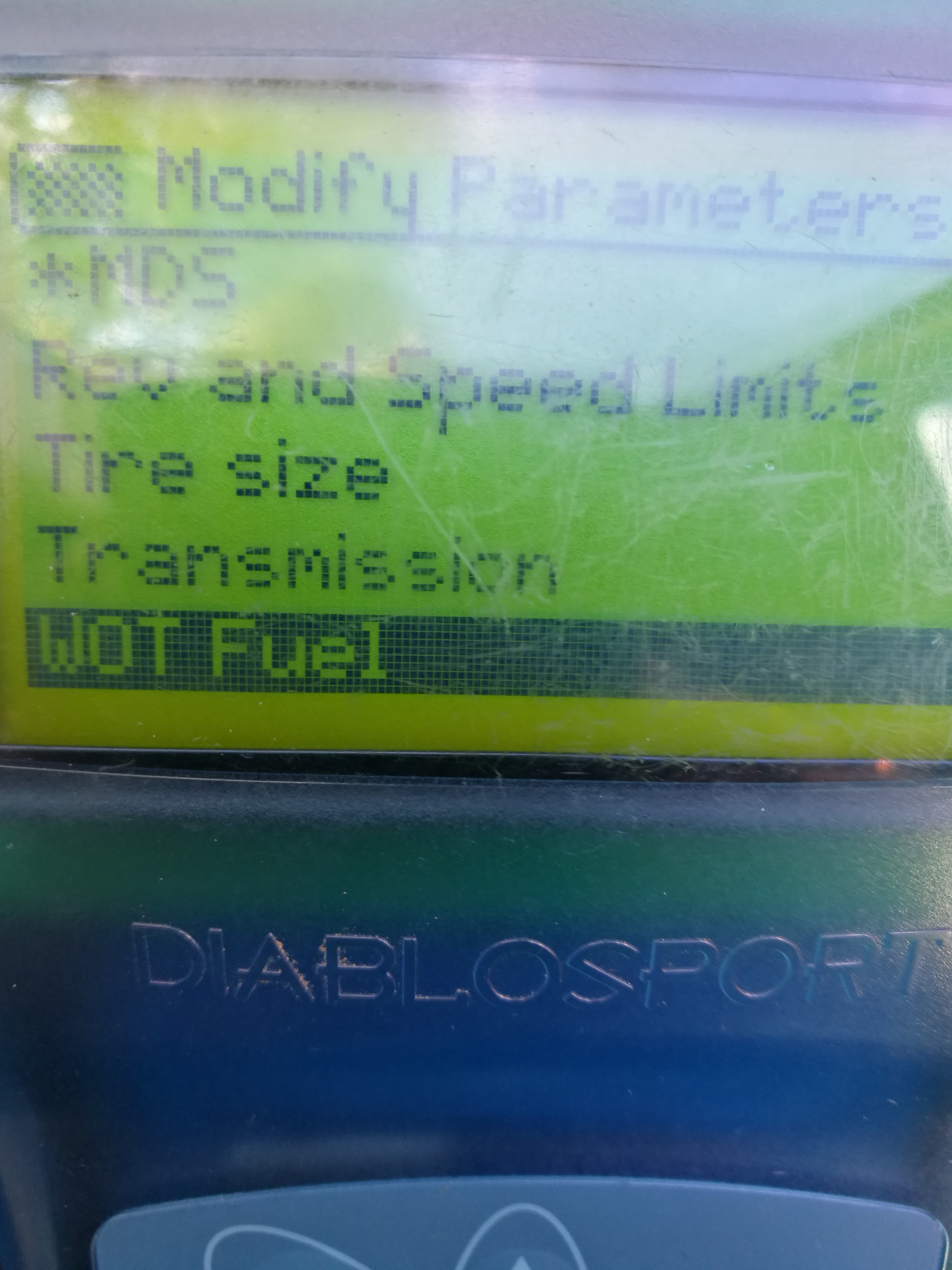

Yeah, the code came back after 30km. It doesn't effect in consumption or anything.. weird.
And I didn't found any throttle adjust. Only idle, wot,transmission,tire size, mds and dyno.

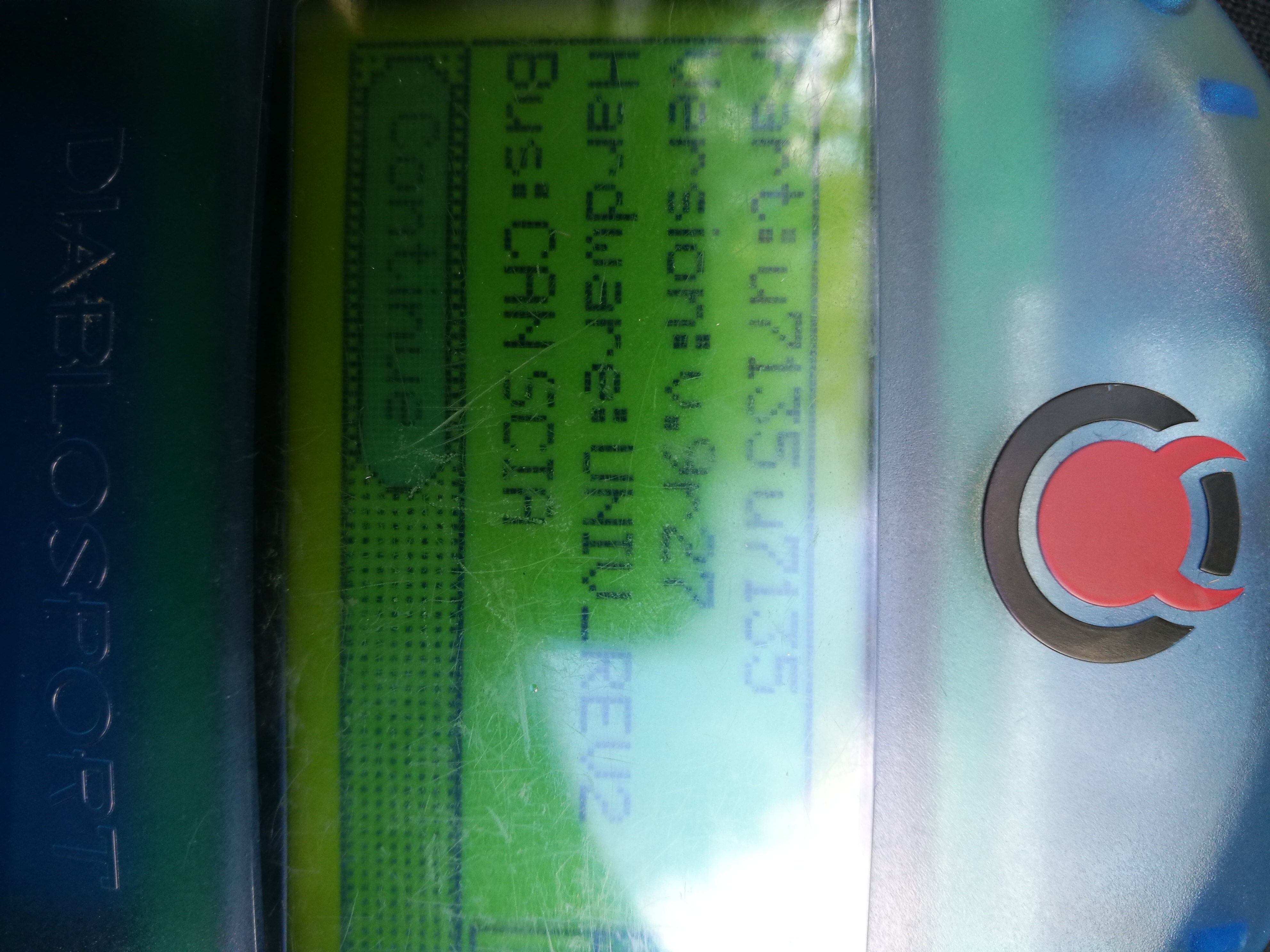

mikel wrote:what version is on the tuner currently?
It's 9r27

Thorvald wrote:
mikel wrote:hmm, throttle boost really should be there. Can you double check?
Checked and didn't found it :oops:
What menus i should go ,where that throttle boost should be found?
These is all i found and that version

Re: Predator u7135 9r27 with 300c 5.7 hemi -05
Post by Thorvald »
Thorvald wrote:
Is there any solution to this?
What does mean that star next to MDS?
Posts: 58805
try loading 9r30
u7135-9r30.crom
(1.18 MiB) Downloaded 551 times
