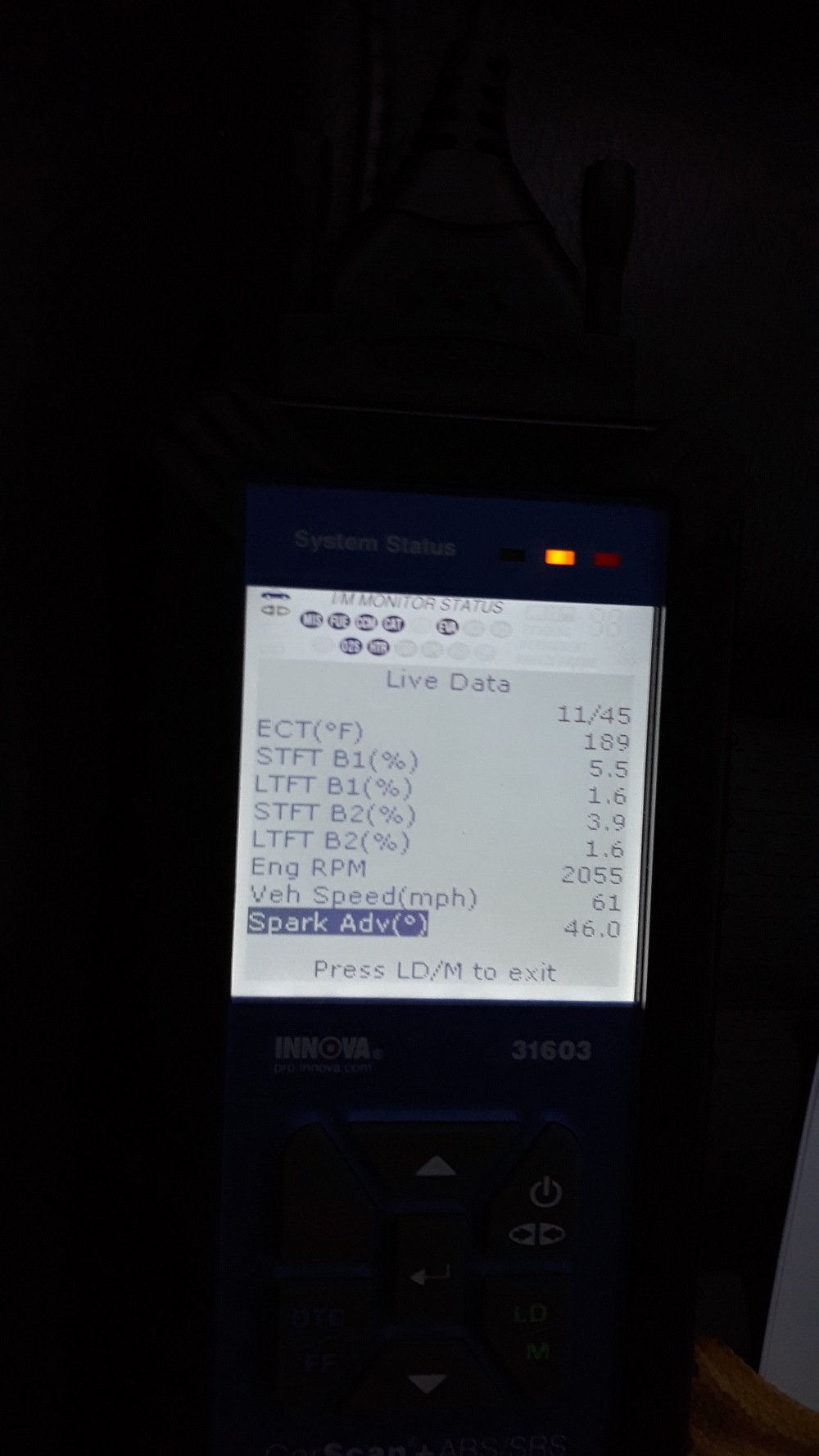

With the Bama custom tune, (stock intake thus far) i had fuel trims high enough to set too rich faults - as high as 15%. Bama responded with a more conservative tune, but felt power was way down. The 'canned' Diablosport 91 octane tune feels much better and stronger, although not dyno'd yet.
The attached image is from the 91 Octane Diablosport tune.

Ok...i finally got the S&B CAI on the car this afternoon. The fuel trims at idle improved significantly compared to the stock air intake & filter.MagsTuning wrote:This referring to the thread in which you already asked about.....https://forum.diablosport.com/viewtopic ... 44&t=82587

Here is what the trims look like tonight on the Diablosport 91 Octane 'Canned' Tune after only 21 miles of driving and I usually see the trims drop even lower after 75-100 miles or so.
How does this look so far to you????
- Posts: 58726
Re: Diablosport InTune S&B CAI Tune???
those trims are nothing to be concerned with, but could be dialed in a bit.
