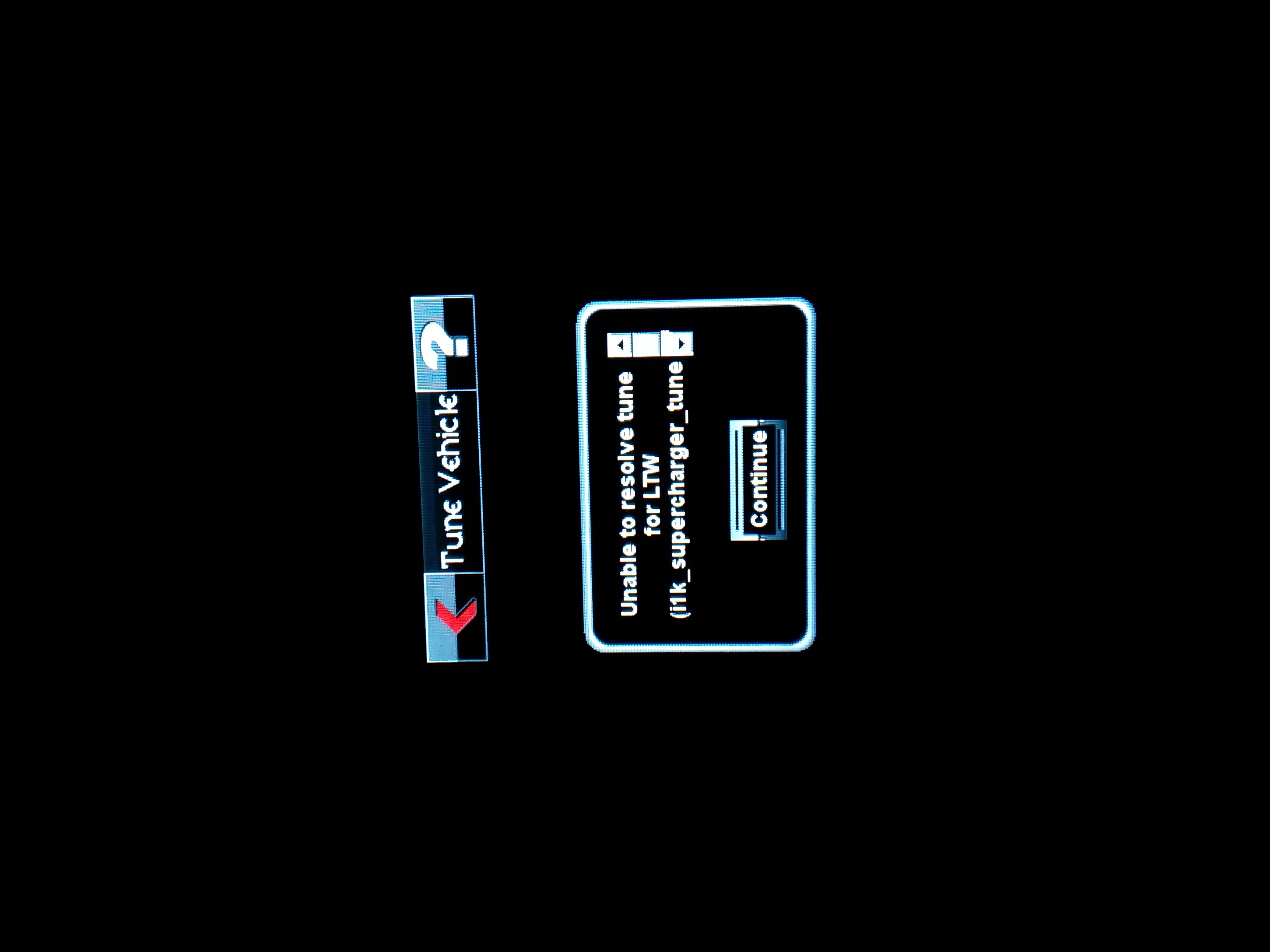

I checked the i1000 virtual disks and they all passed - no errors. I Cleared All Updates, and then reconnected it to the car. I chose the Adjustable Parameters options and now I am getting error "Unable to resolve tune for LTW (tune file name). I selected continue and then tried to load the previous good tune but it won't budge past 0% on Building Tune and the wait symbol doesn't move.

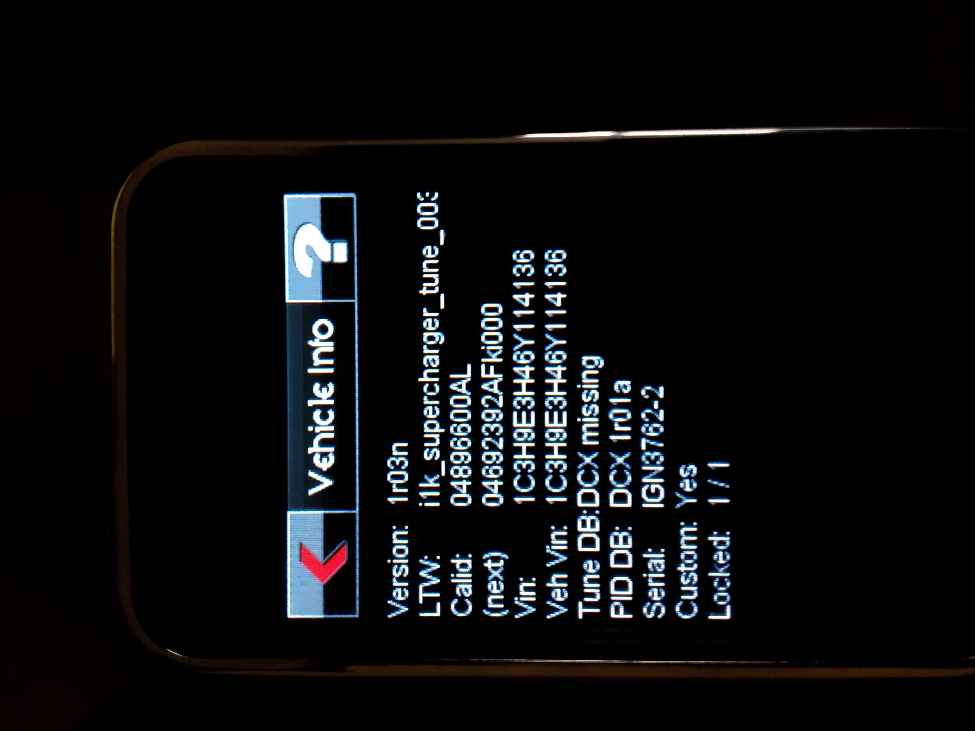

I checked the Vehicle Info and it still has the tune from the previous night. It just won't budge loading a different tune or edit the one that's in there.

The display read that the change was completed and to unplug the tuner, per usual. I've never had an issue with this unit. I attached the info file as requested, plus a photo of the Vehicle Info data, and a photo of the Tune Vehicle error describing the tuner's inability to locate the latest file.
The new file created post-transmission setting change is titled i1k_supercharger_tune_003, which is the file stated in the Vehicle Info menu - LTW (please refer to the attached photo).

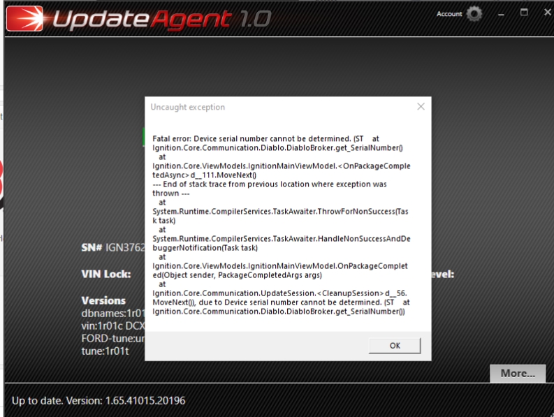

3. Update Agent resumed with the final 2 updates and then presented an error. A screen capture is attached, titled error.jpg. I selected OK and the agent continued.

- error.jpg (271.52 KiB) Viewed 13260 times
