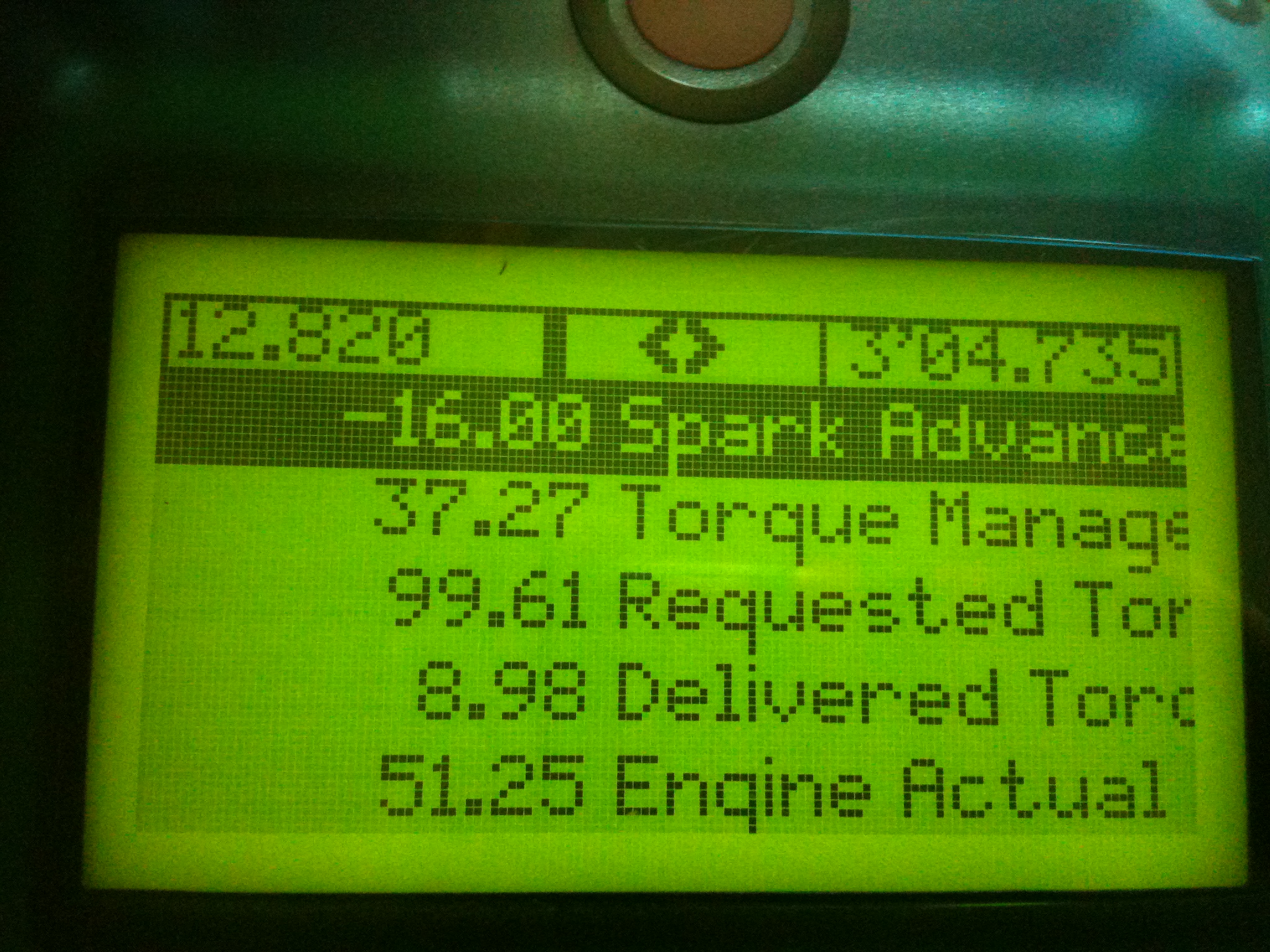

I bought the predator because of the advice of my local speed shop, I told him that i wanted to tune out the factory delay, after checking your web site he said I would be able to disable torque management. I would like to take the truck to my local drag way and would like to get the most power I can. I called tech support today they told me that the v.23 update eliminates TM and only comes in to play at around 6 to 700 hp. So I did the updated and data logged:
requested torque was 99.61%
and only got
delivered torque was 79.69%
Is this thing a waste of money?

Have you logged actual timing to make sure it is maintaining what it is asking for?
h8mud
Joined: Thu Jun 09, 2011 7:44 pm
Post by h8mud »
yes
-16 degrees spark advance
37 degrees torque management retard

from my understanding this tool only eliminates tm on the engine side....unless something changed in 9r23.

rjaro7 wrote:from my understanding this tool only eliminates tm on the engine side....unless something changed in 9r23.
This is my understanding also.It was said here several times that the Predator WILL NOT/DOES NOT have the ability to adjust on the tranny side. Depends on who answers your question I guess. I was told in a previous post that the engine side is disabled in the canned tunes. No way to adjust it on your own I guess.
