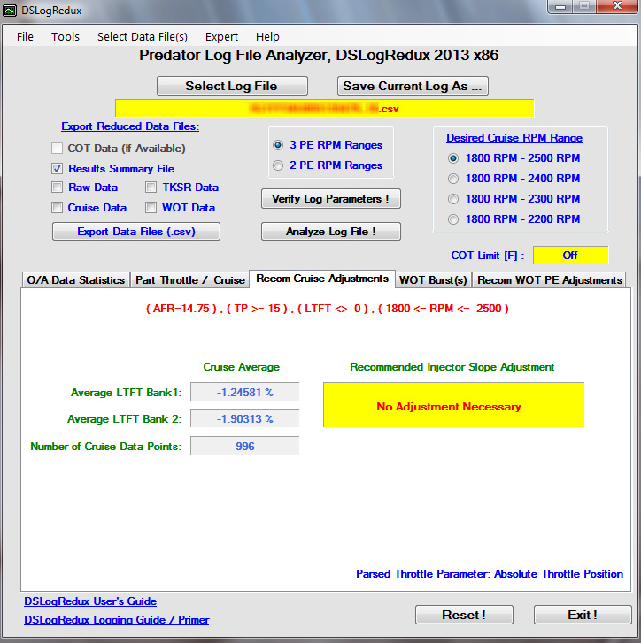

I have a question and I hope someone will provide a link or instructions on where to go from here. I finally have my Injector Slope Adjustments correct, for now anyway, to where the DSLog Tool says "No Adjustments Are Needed".
The post I read said after you get them correct, you can then do the WOT logs and make adjustments at that time for I think Power Enrichment PE. My question is this. What selections do I need to make on the DSLog Program, what PID's do I need to check on the Diablo InTune so that I can do the WOT logs and then use DSLog Program to analyze them and make suggestions on what changes need to be made on the PE?
So I guess long story short, since I have the Injector Slope corrected, how can I now go the next step and Log and Analyze and adjust PE accordingly using the DSLog Utility or what ever program I need at this point.
Thank you in advance and I hope I get some help here. I guess my next question would be after I have the Injector Slope, and the WOT for PE adjusted correctly. What is next, anything, or is that when I need to pay for a custom tune?

- This is where I am at, now what guys?
- Injector-Slope.jpg (182.44 KiB) Viewed 30767 times

custom tuners, like myself, have diablosport's CMR tuning software.. its like hptuners, efilive software.. it's a full tuning suite.. so I have access to everything in the tune file, not just the parameters you have in the tool itself...
I would leave the PE settings alone.. as the diablo tunes already lean that out pretty good compared to stock..
and if you get a custom tune done, I would be changing anything you did anyway

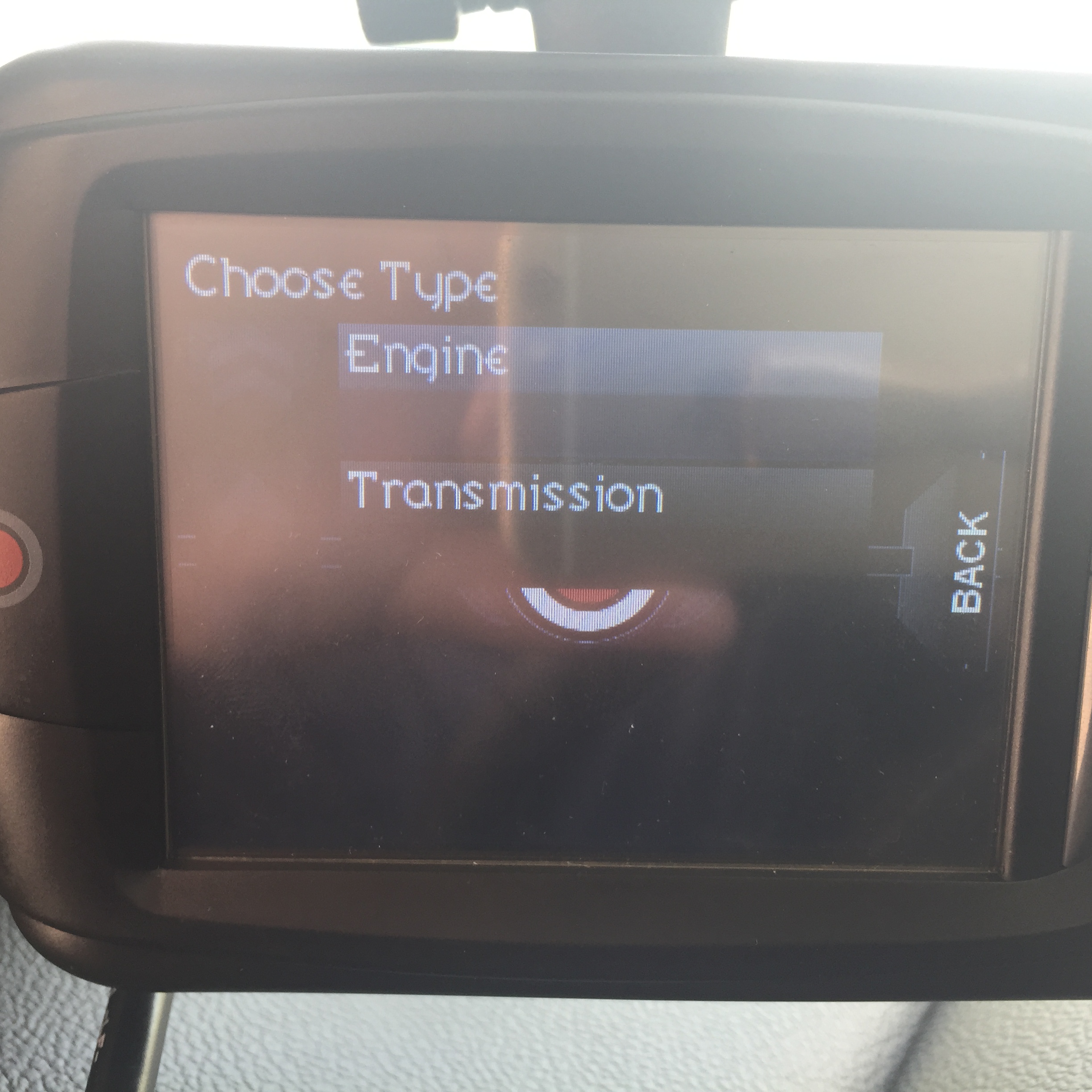

Hey again,
See below picture, this is what I mean by there is no fuel option. I only got to change the engine option which has the PE. So, should I update???? by the way I have a GM/sierra/2015.
