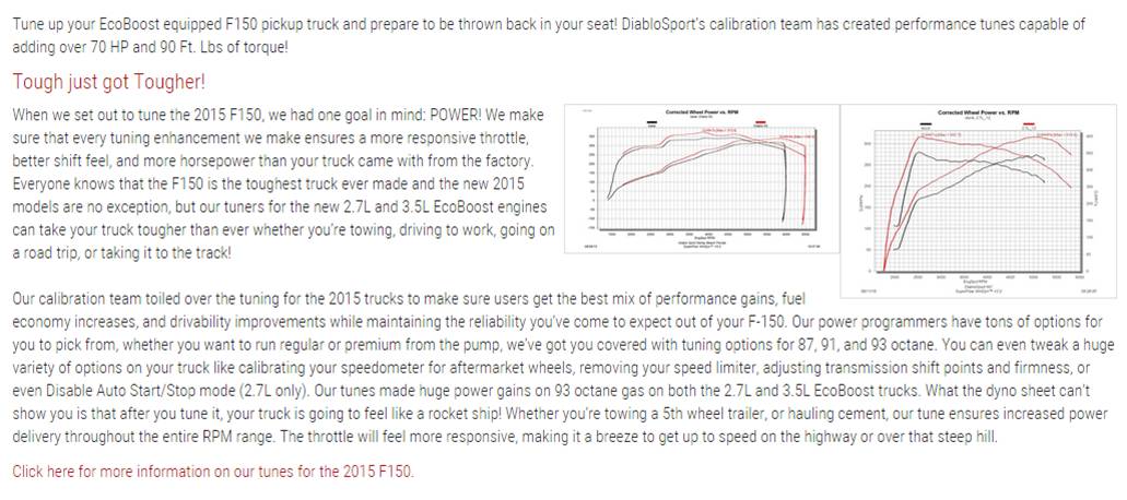

I feel very diassapointed , having a 600+ tuner that does not work with our trucks , 3 months ago when i lost throttle i was in the middle of the traffic, i could have an accident, also i had a customer walking home issue since i left the tuner at home , i have had Superchips, Sct , and diablo before and never ever i had to carry the tuner with me " just in case i had to return to stock" some times i feel disappointed , sometimes i feel really pissed off , at this time i could not believe that Diablo still have on it website the advertising that states "2015 Ford F150 Ecoboost Supported" i dont see it fair that Diablo still wants that people keep buying this @ this time useless bricks and besides that having a chance of get sued if someone hurts in the middle of the traficc :punisher: :normal: :crashing: :drivingbad: :drivingbad: :drivingbad:
