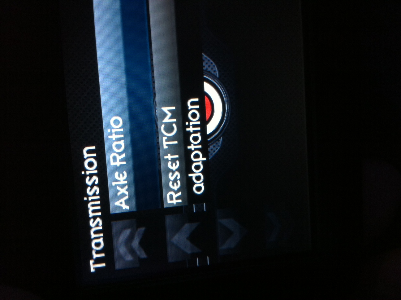

I have a Trinity currently at version 1r13c married to a 2013 Challenger SXT+, and the option "Disable Autostick Auto Upshift" does not appear. According to the documentation, I should have this option.
Any ideas on how to enable this parameter on my Trinity? Would a later revision fix this?

what do you see in the quick adjust menu?

Under QA->Transmission, I have "Axle Ratio" and "Reset TCM adaptation".

OK, will have to look into this.
