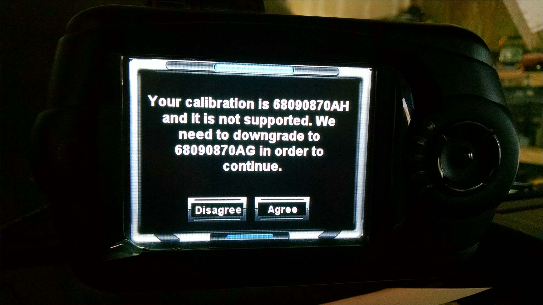

When trying to upload a simple Diablo canned tune to my Jeep I get the message "Calibration 68090870AH is not supported. We need to downgrade to 68090870AG in order to continue."

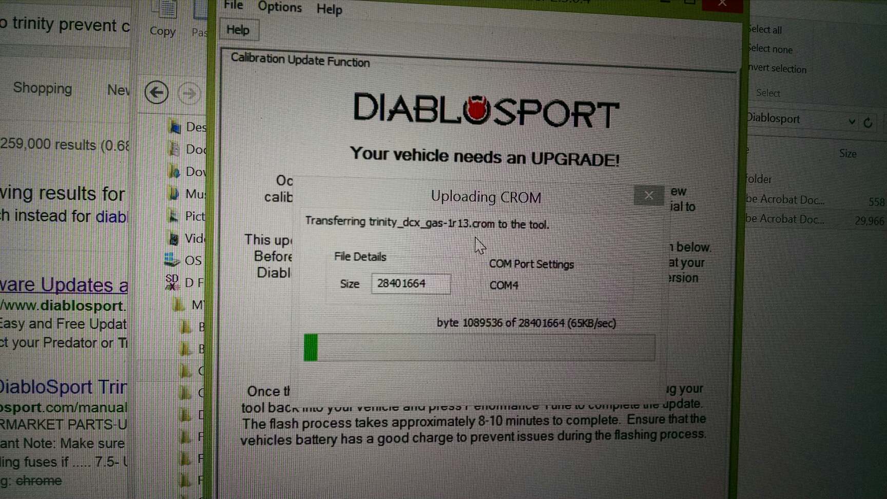

So I connect the trinity to my computer via USB, after having already downloaded and install DSDL w/ drivers. It opens and connects to the device just fine, but then immediately goes into some sort of automatic crom file update for a regular 1r13 crom file, gets roughly 10% into the process and the software locks up. I tried just letting it sit and "think" for about 30+ minutes and still no dice. The issue is that I don't have time to select any other option such as manually loading a different .crom file before the automatic crom updating begins.

UPDATE: I have since been looking on the forum and messing with different things including setting DSDL to turn off autoconnect and just connecting via legacy connect. This does allow me to manually attempt to load the different .crom file that I need, but for whatever reason the Dodge DCX-based .crom files fail to upload. I tried loading a ford can gas .crom file as a test to see if anything could be written to the trinity and that .crom file loaded just fine manually. For whatever reason it does not want to upload the dcx firmware. :normal:
