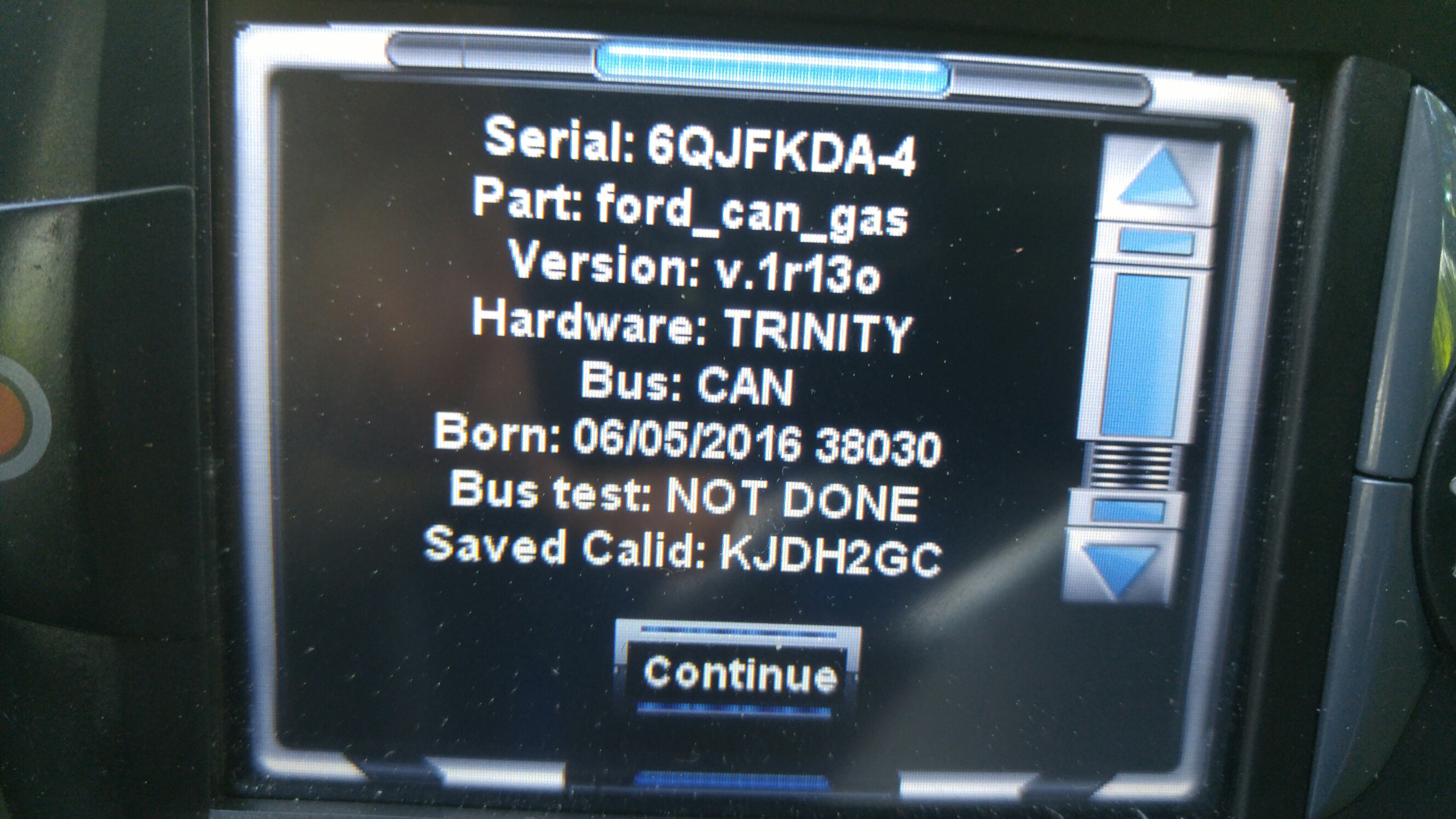

what does the tool show currently under options/show information for version?
DiCunzolo
Posts: 22
Joined: Tue Dec 02, 2014 4:14 pm
Re: 2014 Explorer Sport Trinity
Post by DiCunzolo »
Mike,
See attached.
