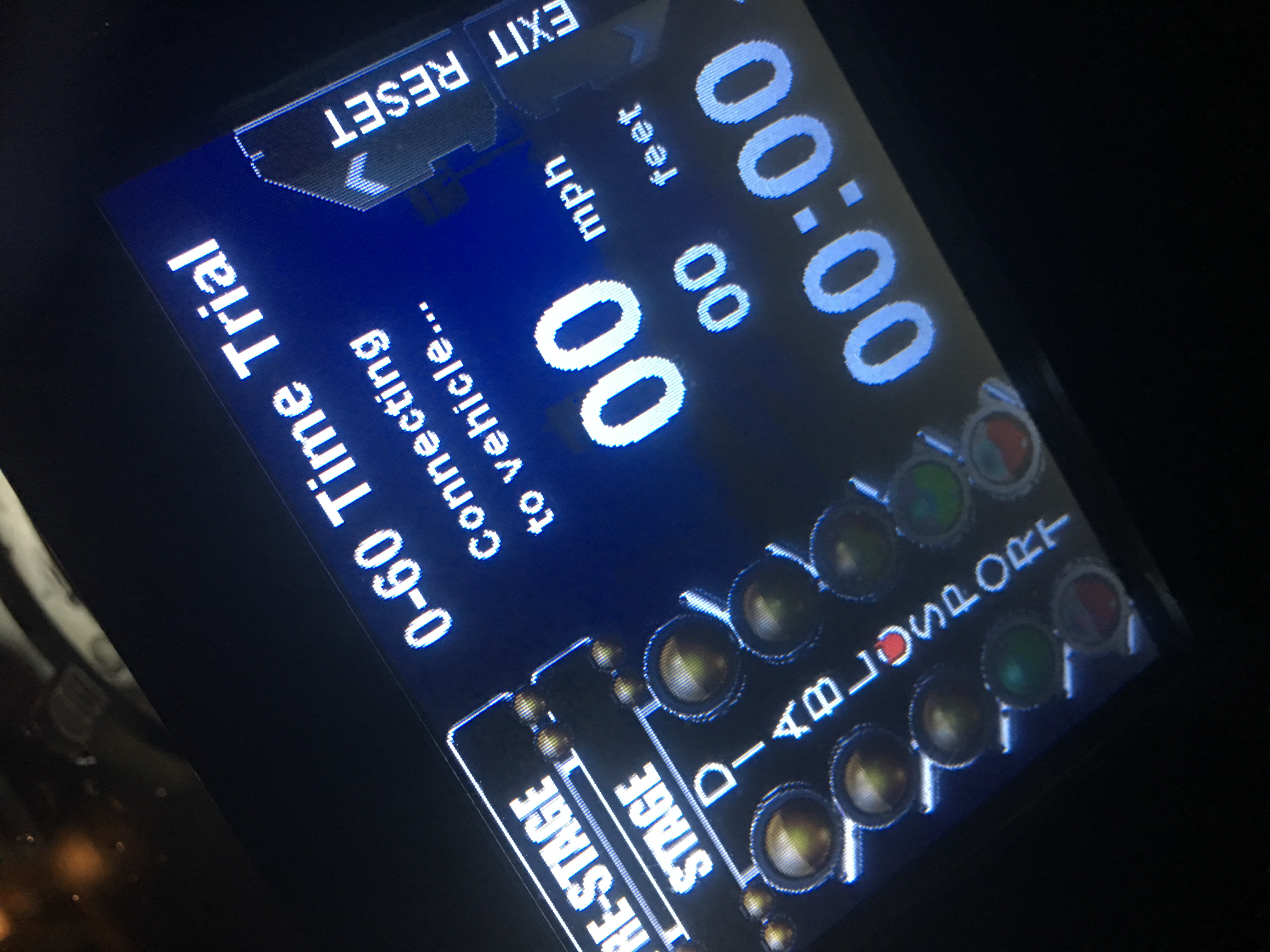

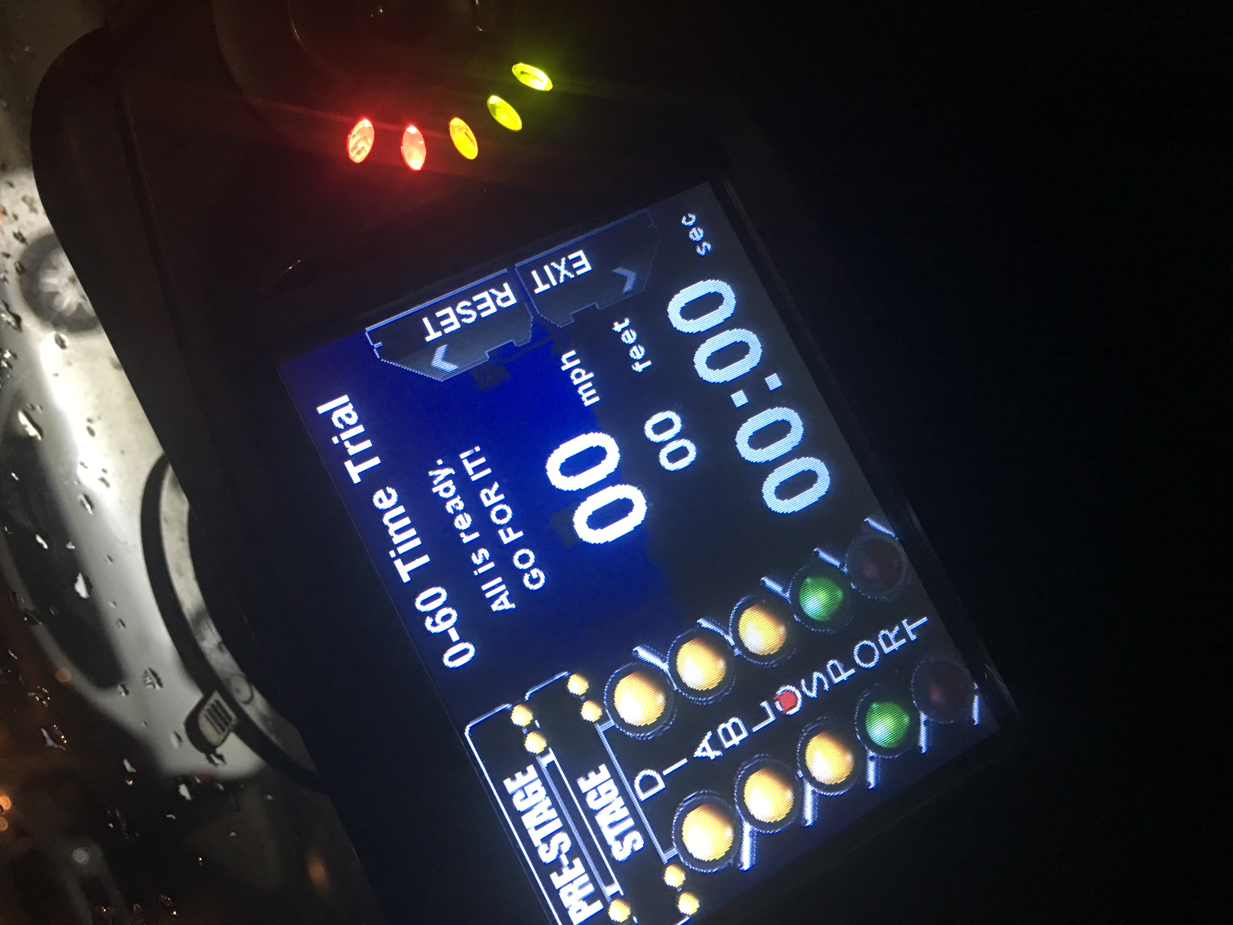

Folks - after working with Danielg for more then three weeks to get my brand new trinity back on its wheels. After you went on your break for Christmas, I learned I have two issues that don't work. Speedo recal for larger tires does not work, the speedo is 5MPH + slower as speed increases as validated by a GPS and police RADAR (don't ask)... and the drag tree does not work in either mode. No matter which setting you put it on. The reaction mode freezes in pre-stage. Motion, trips the tree and says Go, but does not display any data. Press reset, it says connecting to vehicle and freezes. I have to exit the drag tree mode completely. Yes I have the most up to date drivers, DSDL, dataviewer, 2.5 USB driver, and the outdated full users manual downloaded directly from your website. So let us recap what I have. A $600 tool that has not been working correctly as advertised since I bought it, waiting for the $97.00 reimbursement for the dealer re flash of the PCM, because of a tech's mistake out of Ogden, UT, recalibration of speedo that doesn't recal the speedo and a cool dragtree feature that doesn't work. I have a new 2016, F-150, Lariat XLT, 3.5L Ecoboost, with dual cat back exhaust and K&N 63 series cold air intake. During this process, we also learned that the I2 will not work on this truck. I am patiently waiting for answers and solutions, I am a patient person, but I have just about reached the end of the line here. Attached are pictures of the tuners with information screen and drag tree not operating.

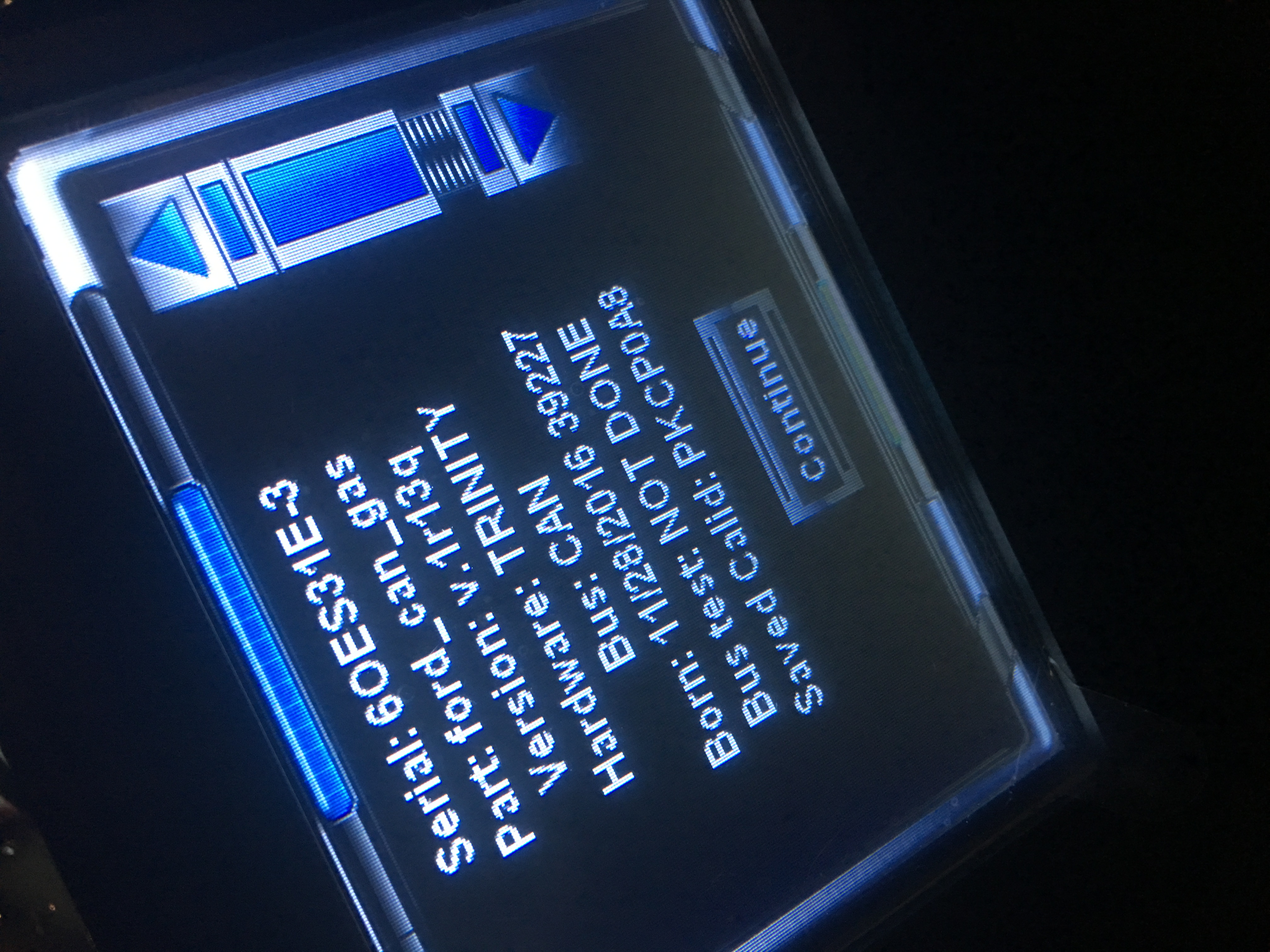

hey Duane,
brian said for you to toss this latest tester into the tool and see if it helps any so we know where this sits if you dont mind.
please let us know :)
