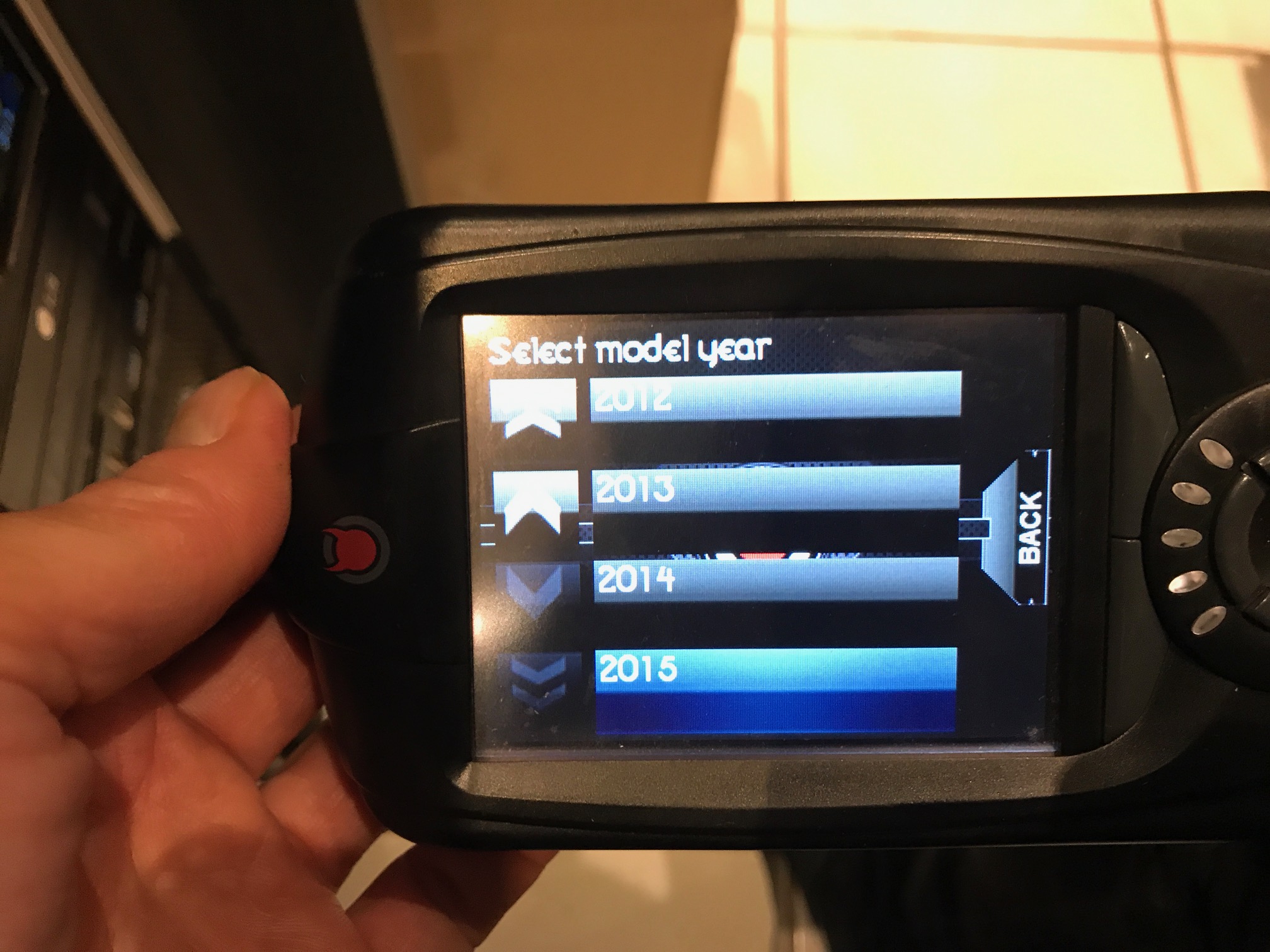

Hi,
I have here a Trinity with the latest Software (just did a update with the DSDownloader).
When it comes to the vehicle selection the newest year is 2015. There is not 2016 selectable.
I have a 2016 Escalade which should be supported.
What is wrong here ?
Please let me know how to select a 2016 Escalade when there is no 2016 to select ...

Re: Cadillac Escalade 2016 not selectable in the Trinity ...
select 2015.. it will take the trinity to the same place it needs to be and will show the proper tunes for your vehicle, as long as you have it updated to all latest updates...

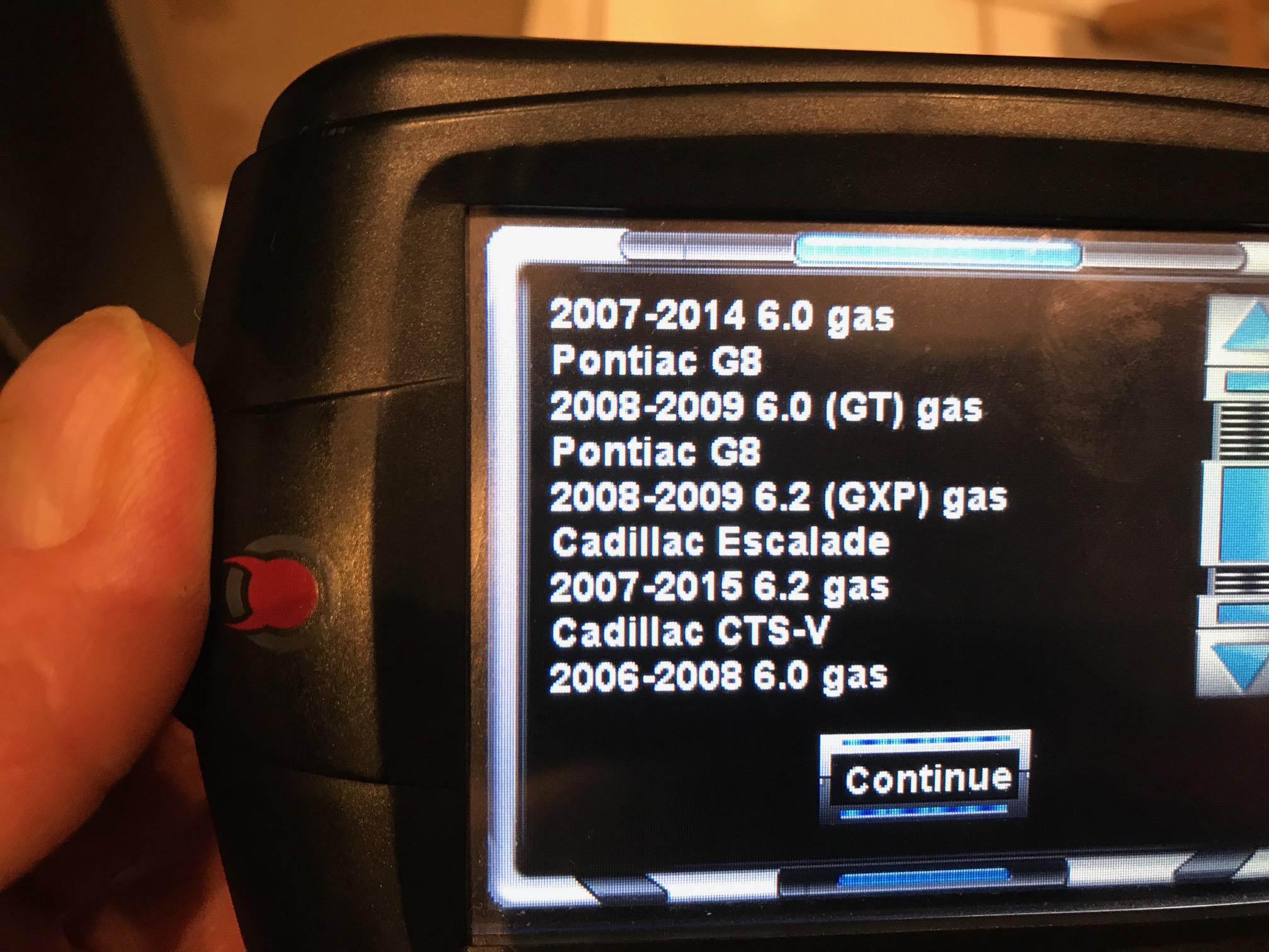

Hi
I installed the latest megacrom from your site.
When i choose 2015 it let select me escalade and then 6.2 engine.
But as you can see in my picture the supported vehicles described in the selected tune file is the 2007-2015 escalade and not the new 2016 model.
Since there is a big difference in the old 2015 and the new 2016 model i think this cannot be the same tune.
Let me know
Thomas
Found the Problem.
I didn´t install the latest GM Gas crom file.
Did that and it let now select me 2016.
