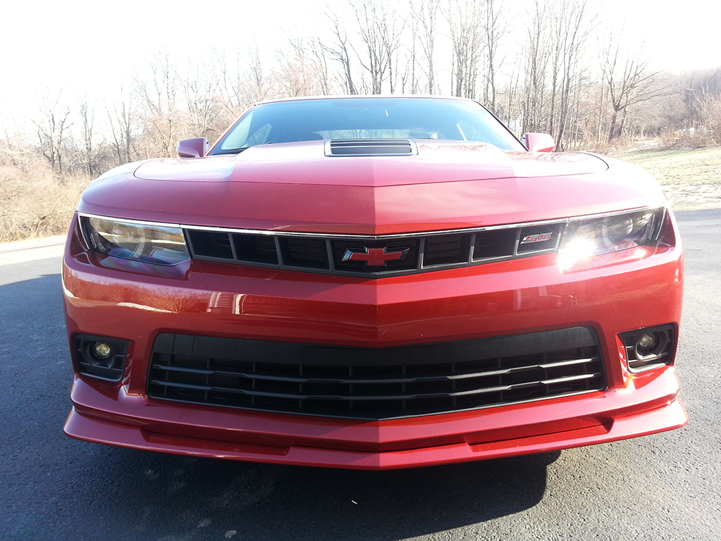

I have a 2014 Camaro 2SS/RS LS3 myself
- nose1.jpg (566.62 KiB) Viewed 7951 times
