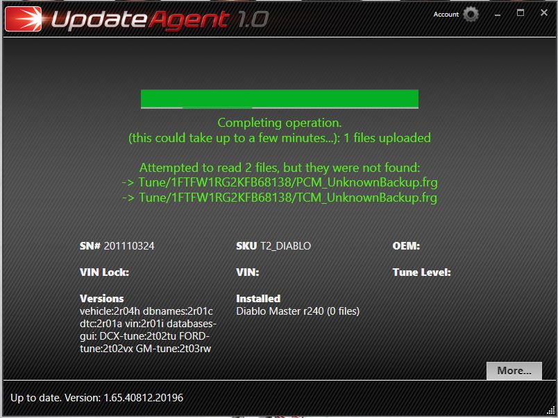

I apologize if this question has been asked elsewhere, but here is my issue. I purchased a additional license on my T2 for Ford. My T2 says it has the most up to date software when I connect it to my PC and run update agent, however I can't access the tune when I connect it to my Raptor. Hopefully this is a simple fix. I also get this error when I plug the T2 into my PC. If I need to call tech support I will do that when I get a chance. Any assistance would be appreciated. I have also attached the info.xml file

- Posts: 58782
Re: 2019 Raptor
what actually happens at the vehicle when you try to tune it?

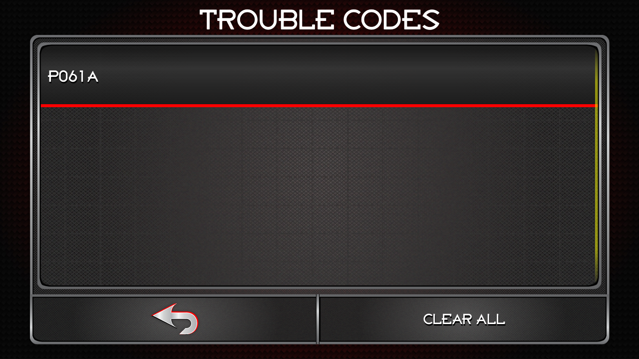

I reloaded the 93 octane tune. I did take the pre collision setting to off for the truck so that wouldn't activate. If I wouldn't have that would have activated and I don't like driving around in limp mode. I didn't get a check engine light this time but I still have the other code I couldn't think of earlier. The photo of the code is attached. It is the Internal Control Module Torque Performance code. So far, the truck seems like it is working fine when I went out and drove it.

- Posts: 58782
Re: 2019 Raptor
Thanks, we're checking this out.

It happened again. I have attached a screenshot of the trouble codes.
I accelerated to pass a semi on a two lane road and just as I got around him the truck had the check engine light come on and I lost almost all power to continue to accelerate.
I have removed the tune from my truck until there is a remedy.

- Posts: 58782
Re: 2019 Raptor
ok, sorry about that, we're on this and will have a fix asap.
- Posts: 58782
Re: 2019 Raptor
the fix is ready, please update your device then you can reload the tunes with no codes.
Let me know if you need anything else.
