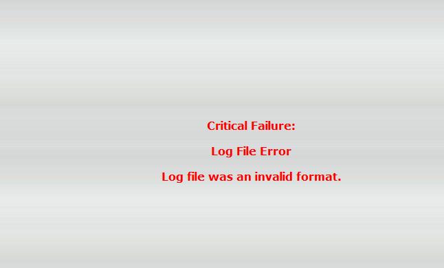

johnc wrote:
Xavier wrote:I had to Drag-n-Drop the log file into the open window in the DataViewer to get it to show up. Try that, let me know if it works.
The proper way to open the files is to start up the DataViewer and then use Open Log from the File menu OR click on the first icon on the toolbar.
Tried that, won't open. Here's the error I get in .jpg format.
EDIT - I can see them fine, just won't load...
johnc
Posts: 1034
Joined: Thu Jun 07, 2007 8:42 am
RE: Re: RE: 06 MSRT8 Data Viewer Run
Post by johnc »
The file opened just fine for me. Are you sure you downloaded all 151k of the file? Right click, go to Properties, check the file size against what he posted.
