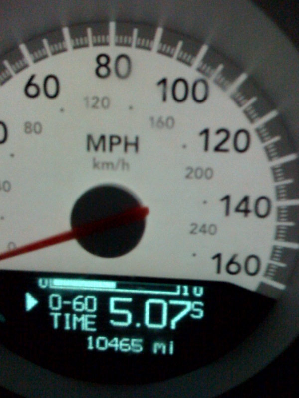

0 to 60 Time
I took a pic of the 0 to 60 Time of the run above.
- RT0to60photo.jpg (107.37 KiB) Viewed 3566 times

RE: 0 to 60 Time
You have to change MBT Spark to be the same in each range.
For my comfort, that's still too much knock, especially since it ramps up during the pull. It looks to me like your fuel really can't support the 93CAI timing. I would try different fuel or start with the 91CAI as a base. With your mods, I wouldn't expect you'd need to add much fuel to the canned tune to get it right.
0-60 time is influenced by so many things that it's not useful for me to comment. With an auto, on a consistent level surface, with a consistent launch, you should be able to measure relative improvements, but that's a lot of if's.
