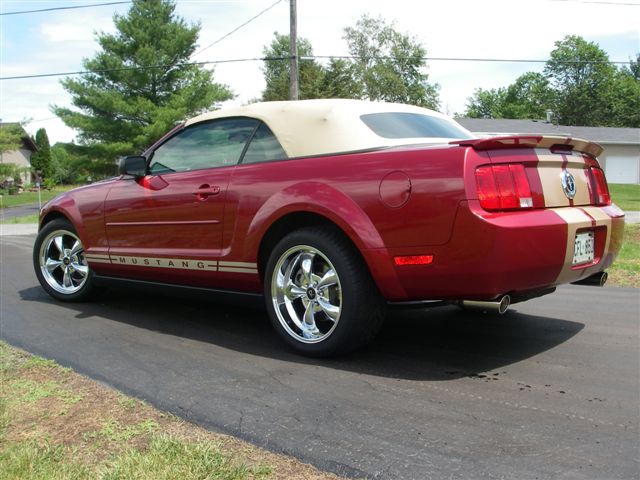

My 2007 Mustang V6 currently has the Magnaflow Catback dual exhaust and an Airaid Cold Air Intake. I want to add 3.73 gears with a BBK 70mm Throttle body. I have programmed the High Octane firm shift (Airaid) tune. Will this need to be adjusted for the new mods?
