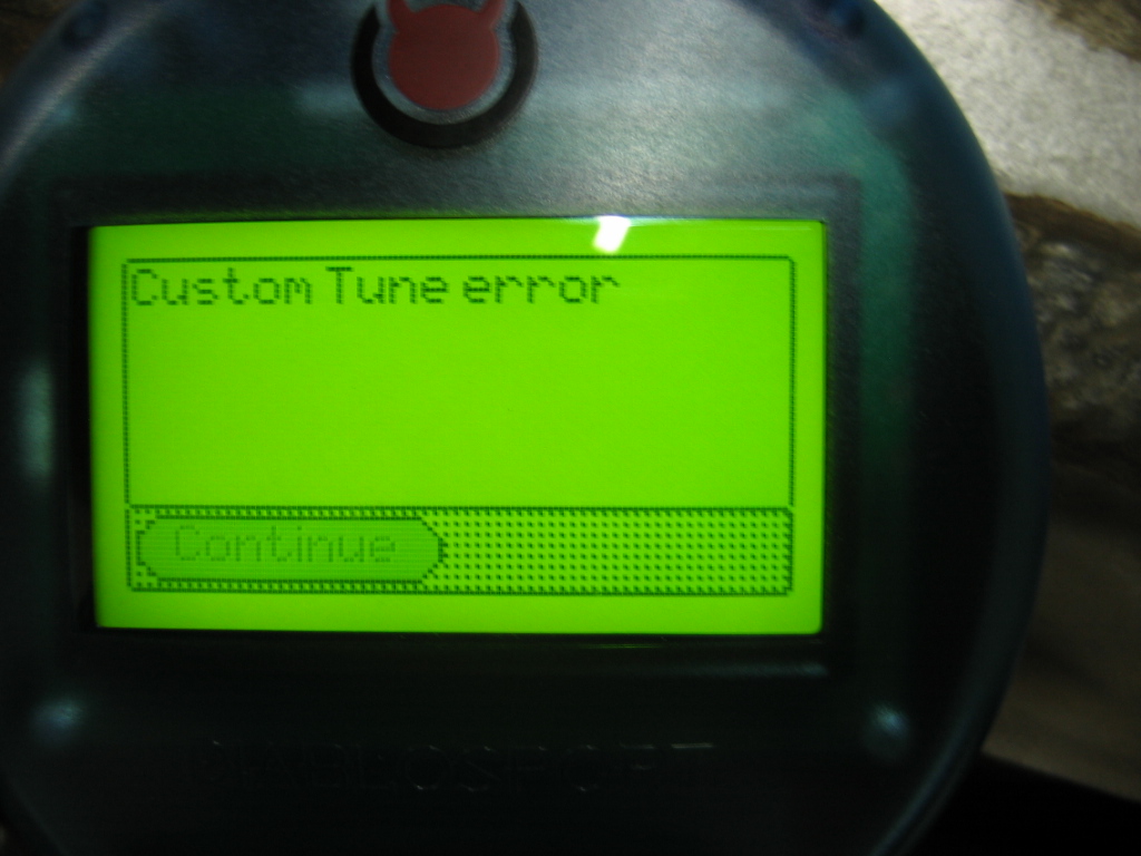

same problem
Posts: 58701
what is the issue exactly, word for word please.

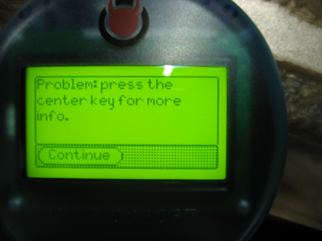

Here you go

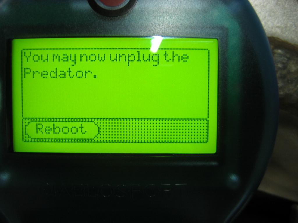

after hitting continue<br /><br />then I just unplug, because it just reboots and does the same thing over again

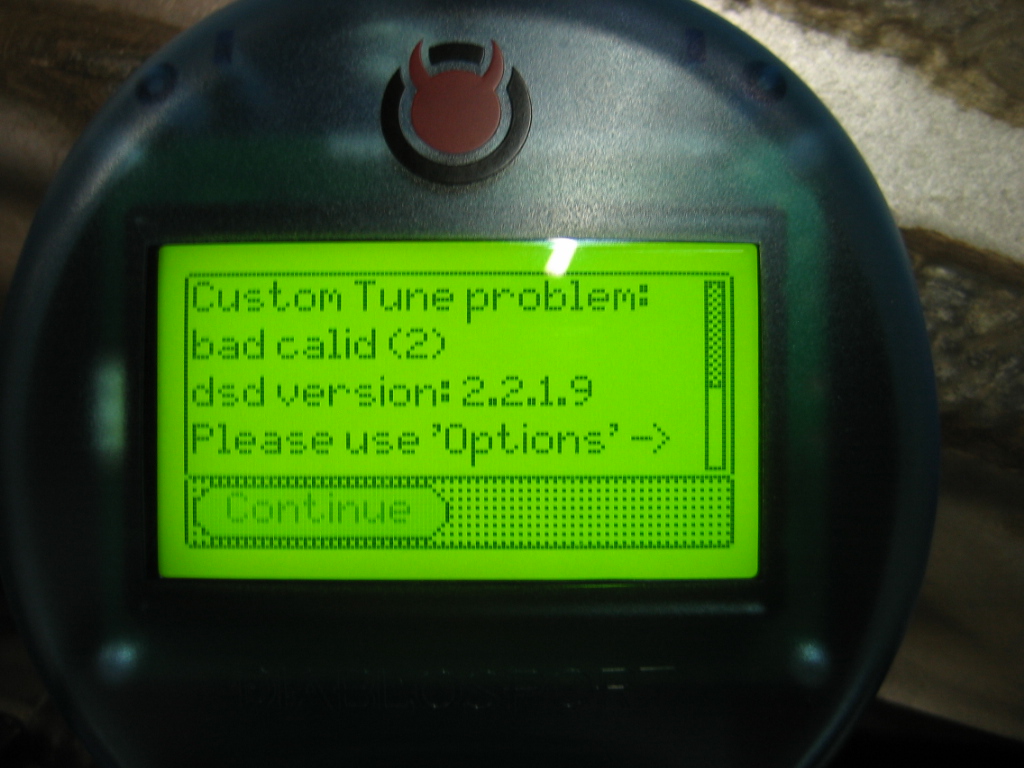

scroll down to this
scroll down to this
first error
first error

Posts: 58701
Ok, think this will do it.
Restore the stock tune, then update the Predator to this new version.
The tunes should load fine then.
u7151_f150-9t11a.crom
(980.76 KiB) Downloaded 527 times
Posts: 58701
The tunes willwork, but you will want to export a new copy of the original backup file and use it as your base file when loading the tunes I posted.
Posts: 58701
Actually, once you get it updasted, let it read the backup, post it here, and we'll have to make new tunes afterall, will take me 2 minutes ;)
