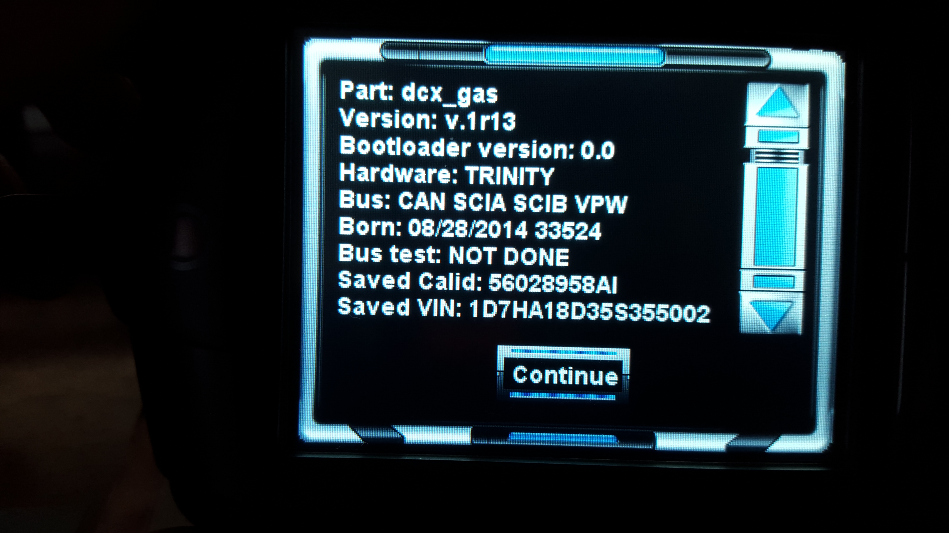

by AZHEMI
This box just as every other person who has an 04-06 ram hemi...the trinity does not read nor remember the TCM backup

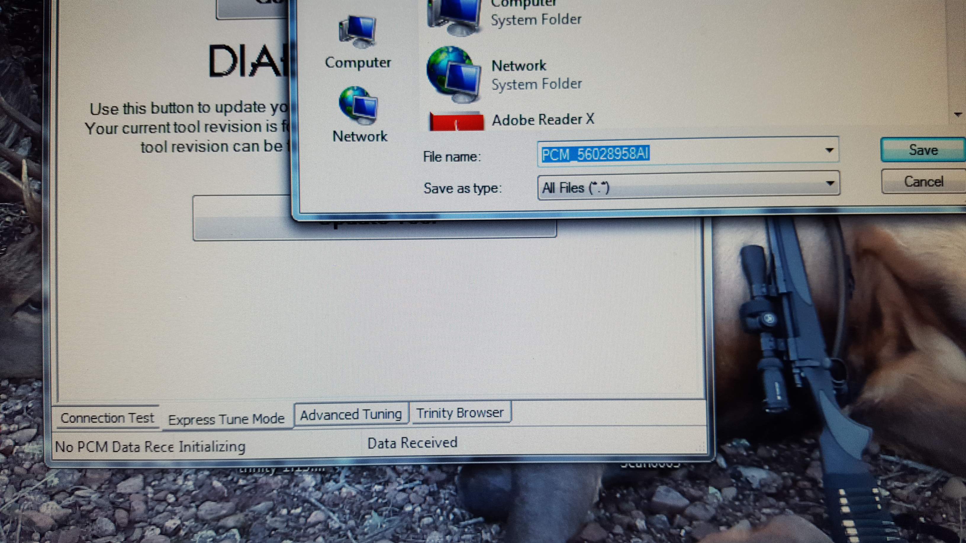

by AZHEMI
No TCM backup
No TCM backup
It remembers the pcm back up, save it then it goes to look for TCM thats when u get the error box
It remembers the PCM back up

by AZHEMI
It writes pcm, and have no tcm written

by AZHEMI
This is all the info that the trinity shows
It only saved the PCM
I can upload my stock TCM file and PCM file to see what you guys can do with an update for the 05 ram hemis.
