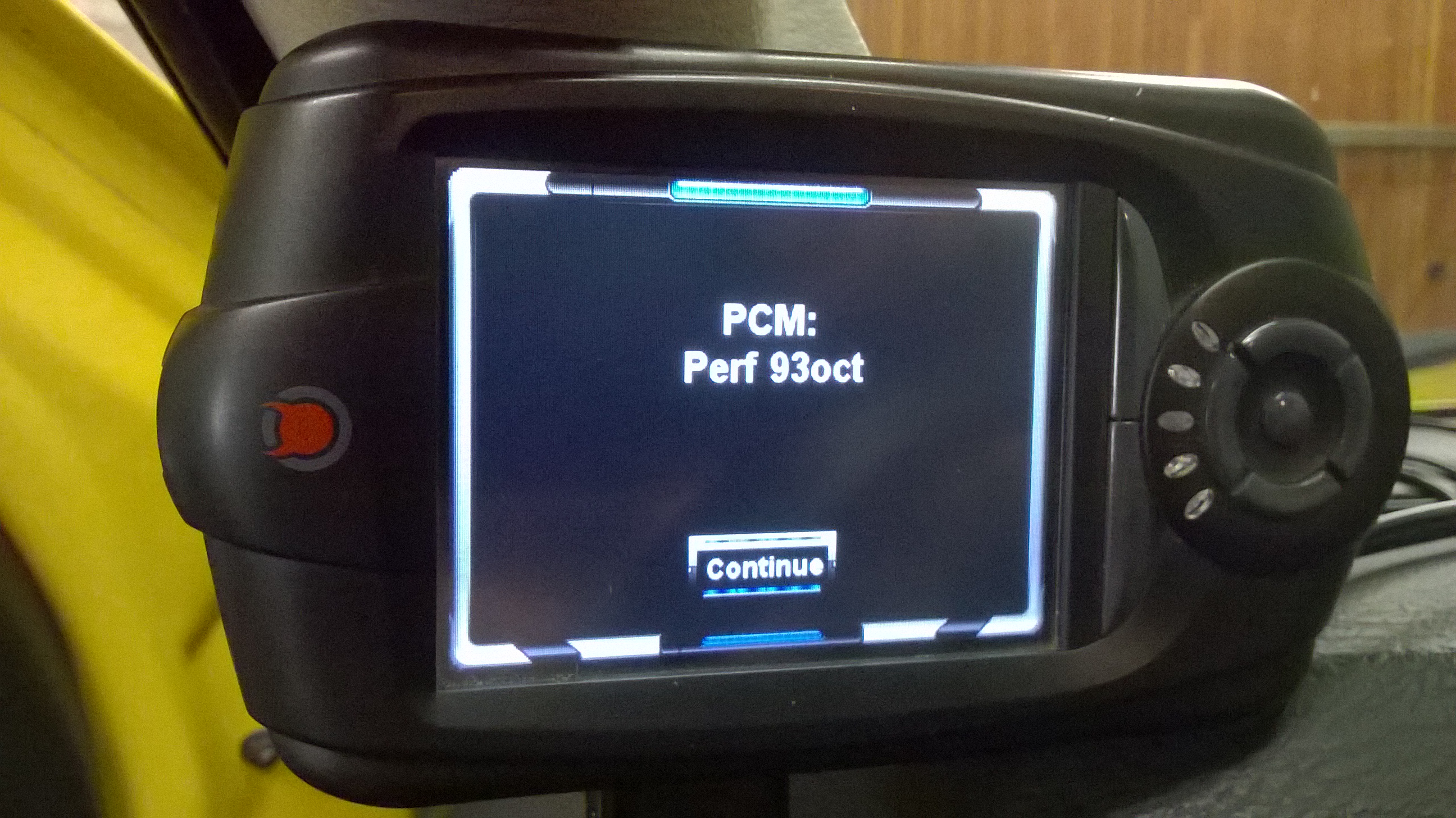

Still trying to retrieve back the TCM tuning and here is what's happening....
So I restored the original backup and updated the tool to the last dcx_gas 1r13b crom version.
Back to the truck to tune it everything is running OK reading/writing PCM/TCM proccess is OK....
Original backup saved in the tool.
Then I load the canned 93 oct. perf and all the process is running OK and the tool offers me the Perf Trans tune .... Keep going until the end of the install and here is what I get.....seems PCM and TCM files are in the tool... Once the tool tells tune is in the vehicle you may drive it..... I press Continue then toll is rebooting....OK
But once rebooted, when I press options > last tune written here is what it shows... also when I try to get TCM tune file from tool, I got the error message I posted above
What can we do please ???
I have no more custom trans tuning avaiable and I paid for it
Thank you for your help...
