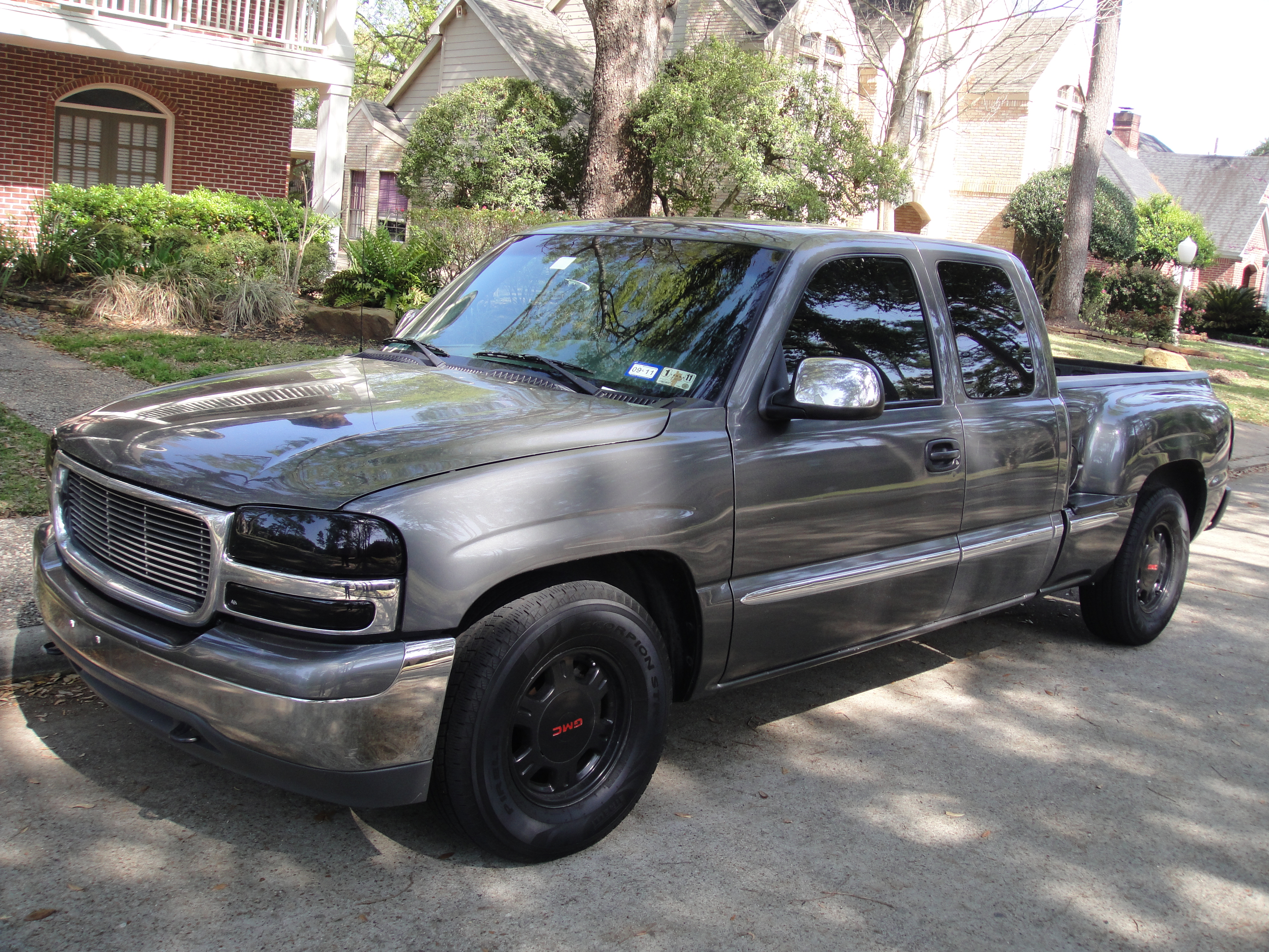

this is my truck we have to work with i have done
k&n cold air
proweraid throttle body
pypes cermanic coated cats 200cells air flow
flowmaster dumped
eibach shackles
Posts: 18104
nice lookin' truck man!!
08Silverado

Holy big picture batman!

seriously, I have a 24" monitor and it exceeds it in both dimensions. I now have to scroll just to hit the submit button...LOL

thx idk y the pic came out soo huge lol
nice looking truck u need to do shackles on it will look so clean single cab trucks wit shackles look really good and its only 75bucks for eibach and they are really nice
