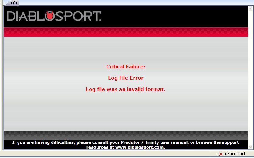

Can't open the file...
prohunter
Posts: 69
Joined: Mon May 16, 2011 3:53 am
RE: Data Log
Post by prohunter »
I thank u have to download it then veiw it with dataviewer from diablo
abuelo
Posts: 76
Joined: Sun Jan 23, 2011 10:43 pm
Post by abuelo »
Yes, i tried to use the datalogger, this is the error I see. Maybe I'm doing something wrong; not unfamiliar with dataloging.....but this is the firts time I use the DS dataviewer
