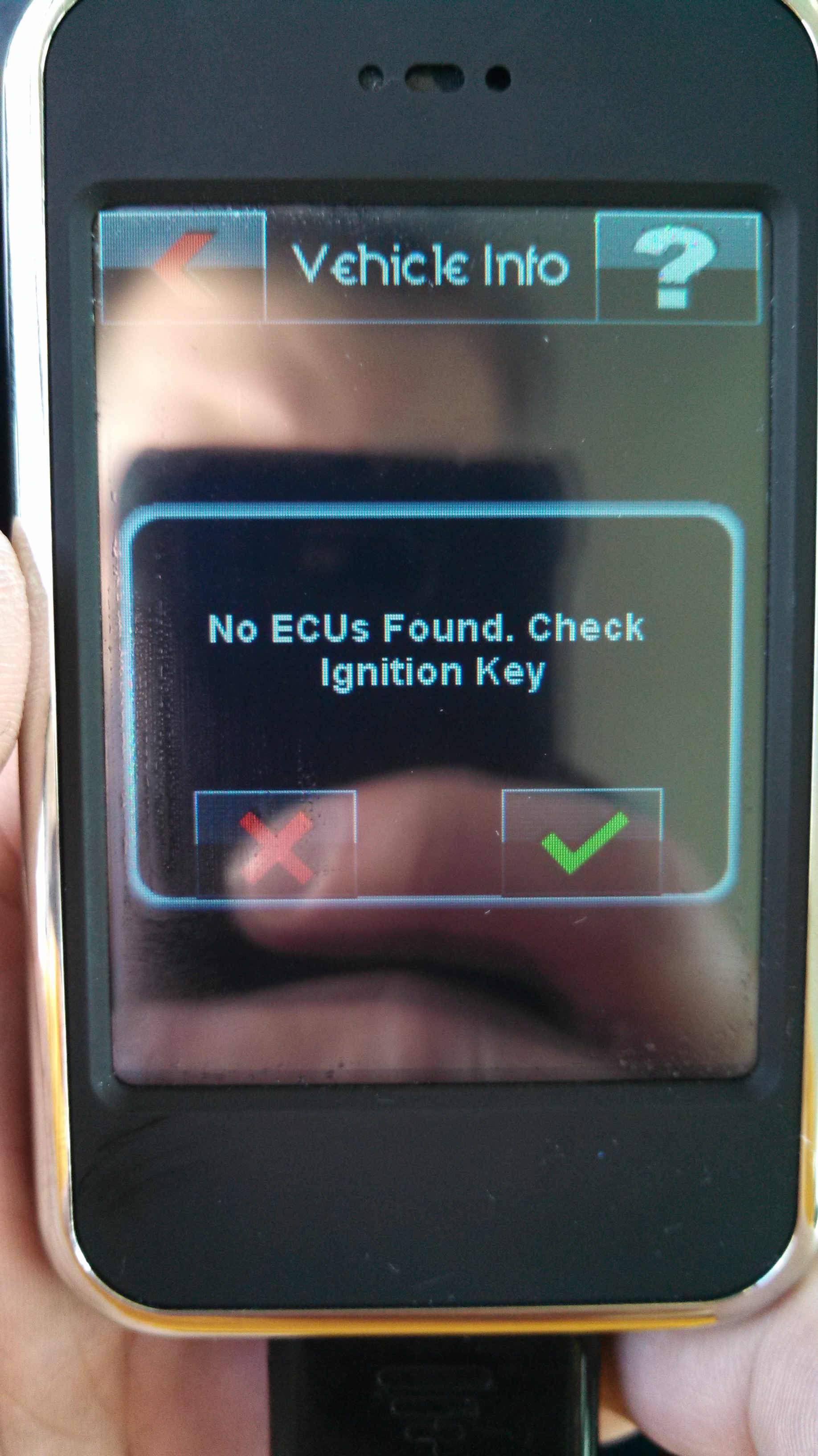

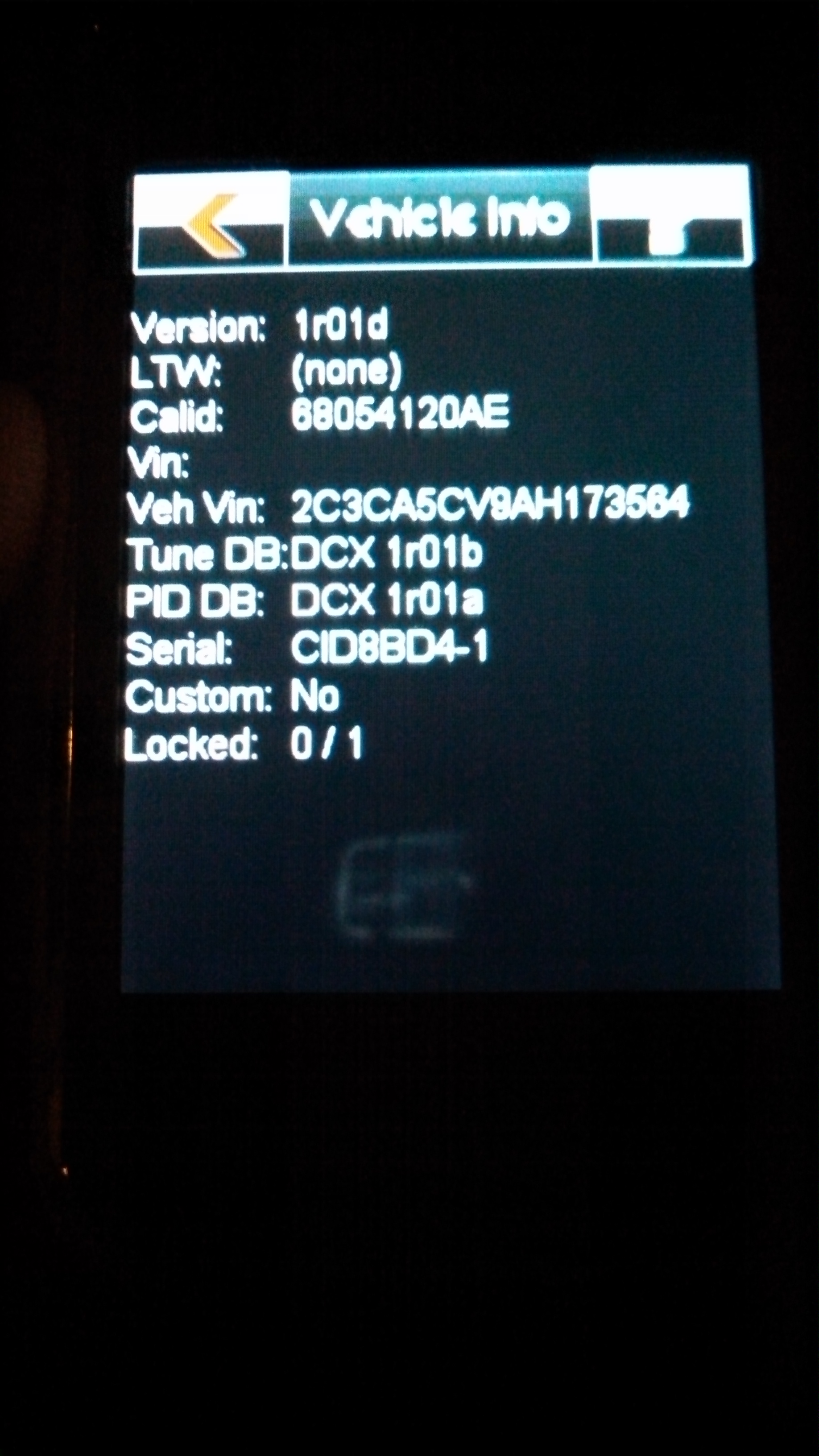

Have had the intune since April 2012 (2010 Chrysler 300 touring 3.5L with 4speed transmission). After a few issues getting it going initially, I settled on the 89 tune with some adjusted parameters (throttle position sensor, fans, etc) Pretty much no changes made since early fall. Thought I was going to have to take car in for some warranty work the other day, so went to restore original tune and it went into recovery mode. 2 days later, plug it into computer and it auto updates and no longer says its in recovery mode. Plug tuner into car and it wont identify vehicle (says no ECM identified) and then shows me the previous vehicle info (which has correct VIN for my car). Back out to write vehicle and it seems to identify ok. Starts backing up "original tune" and then tells me "ECM appears to have been tuned, no back up saved" and then exits. If I try to restore vehicle it just loops and does nothing. Even went into advanced settings to force original backup at which point it tells me that there is no original backup stored on device. Please tell me how I can restore my original tune. I believe I made a backup and am currently looking for it, but even if I load it on to the intune as a "custom tune" it appears that the unit won't write anything at all. If I can't find the copy of my original tune, is there a way to get a base tune back on the ECM? Should I delete the stored vehicle from the intune? I am attempting to add some pics and video.

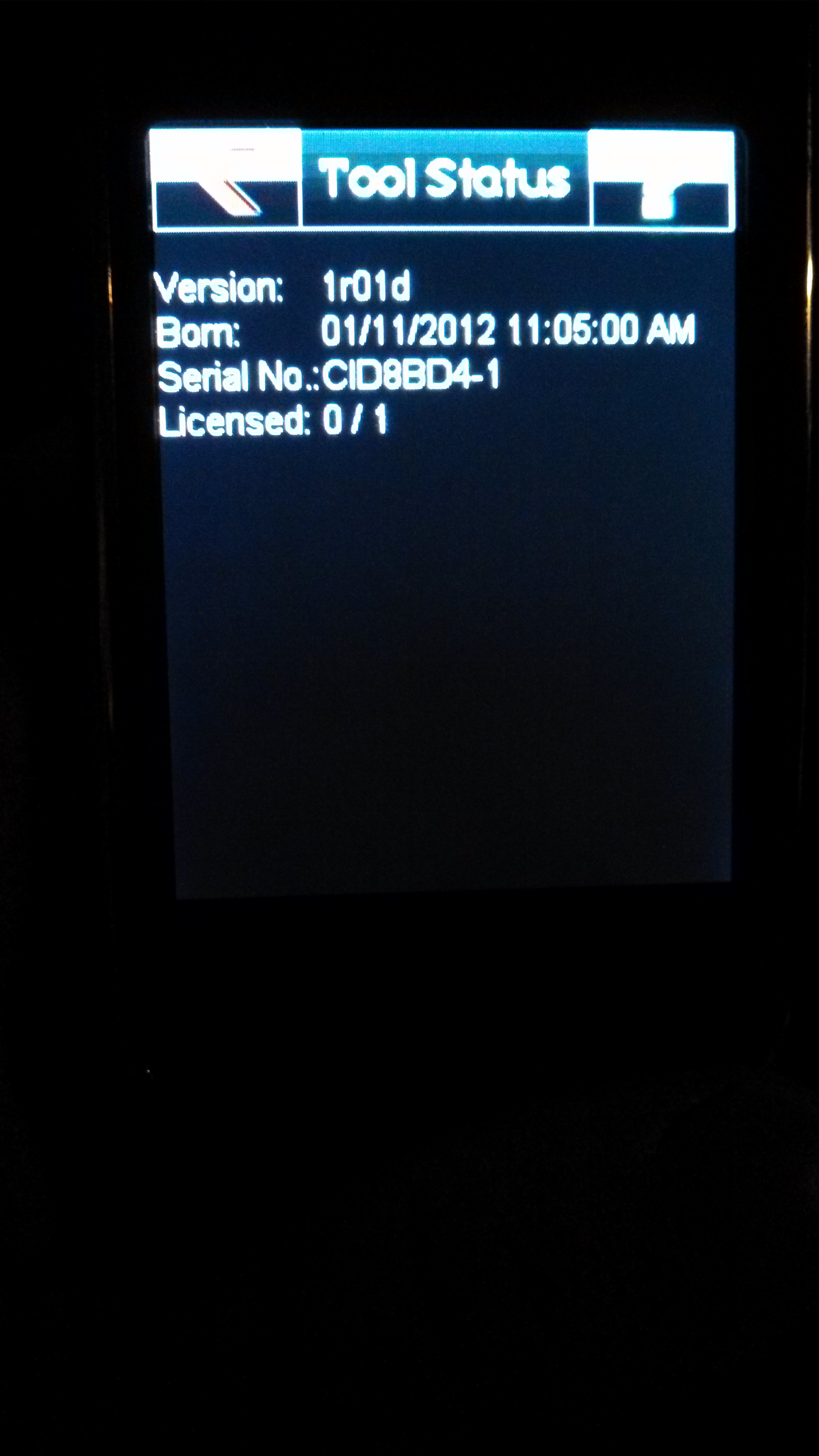

PS - here is from the info folder in the intune (have no idea what that stuff means :oops: )
<?xml version="1.0"?>
-<tool_info> <main svn="3753" sw_rev="1r01d" full_version="InTune-1r01d 01/11/2012 11:05:00 AM"/> <registration status="1" sn="CID8BD4-1"/> <restore bc="0" vin="2C3CA5CV9AH173564" id="0"/> <db pid="1r01a" tune="1r01m" mfr="GM"/> <db pid="1r01a" tune="1r01b" mfr="DCX"/> <db pid="1r01a" tune="1r01i" mfr="FORD"/> <system_db vin="1r01b" info="1r01b" dtc="1r01a"/> <license tuned="0" avail="1"/> </tool_info>

Mike, I did do that and it updated but kept telling me file is incompatible, reverting to last firmware. Subsequently, I manually upgraded the firmware to 1r01g. It will now see the ecu (on second attempt). When i plug into pc it tried to update to latest firmware goes through preparing and writing and then tells me fike incompatible reverting to last firmware (stays on g). If I try to restore vehicle (regular or forced) it tells me there is no backup available for my vin. I am afraid to write a performance tune at this point because I don't want to run into a glitch (absolutely can't be without my car at the moment). Gonna try to attach some more pics.
