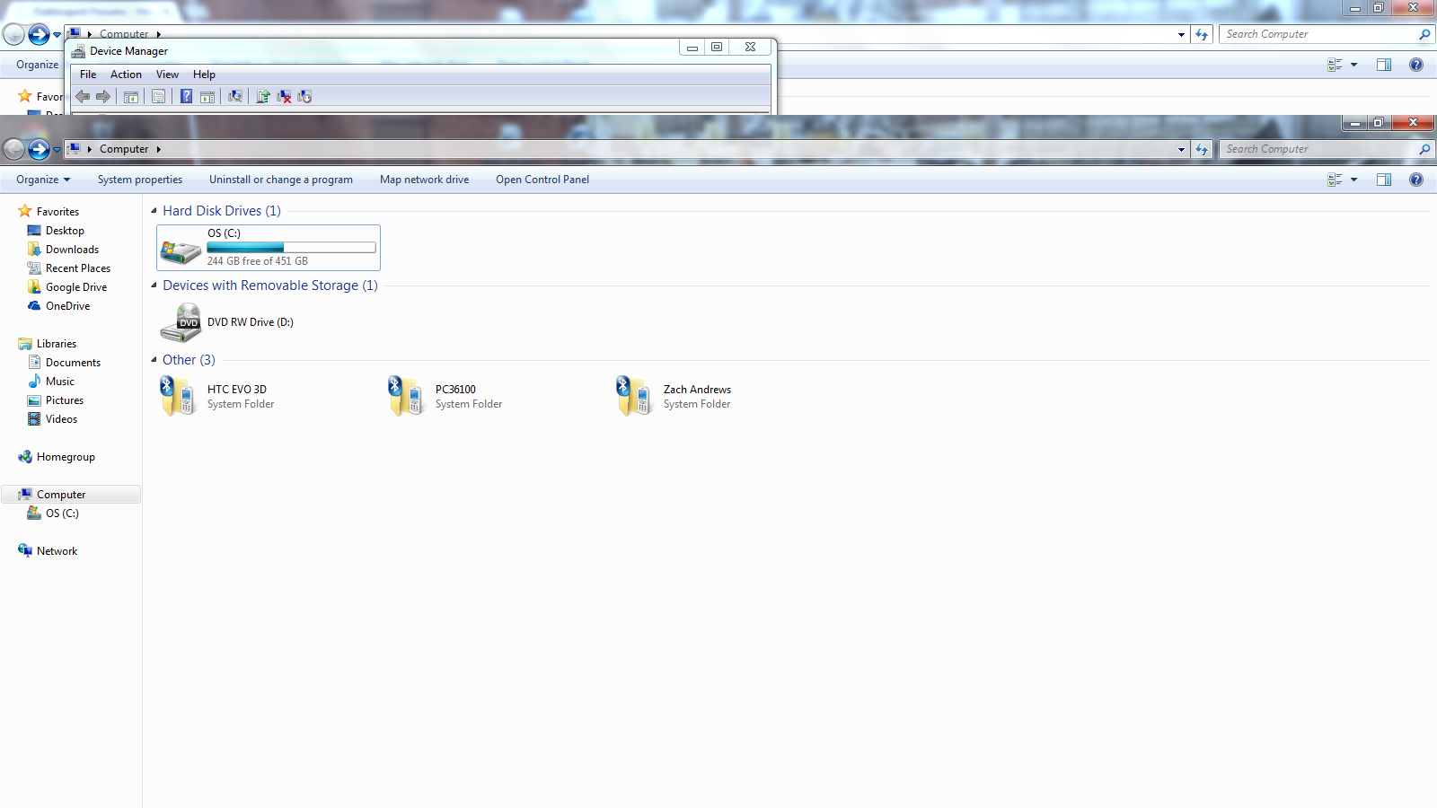

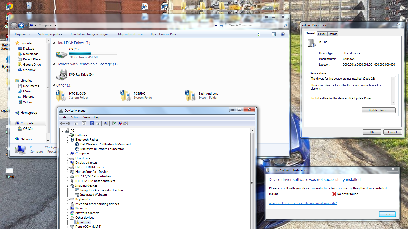

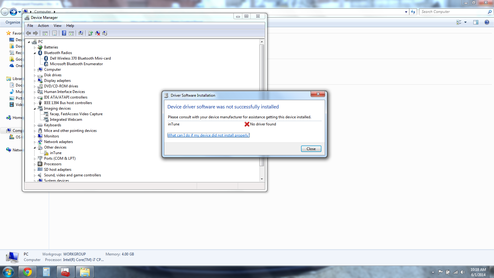

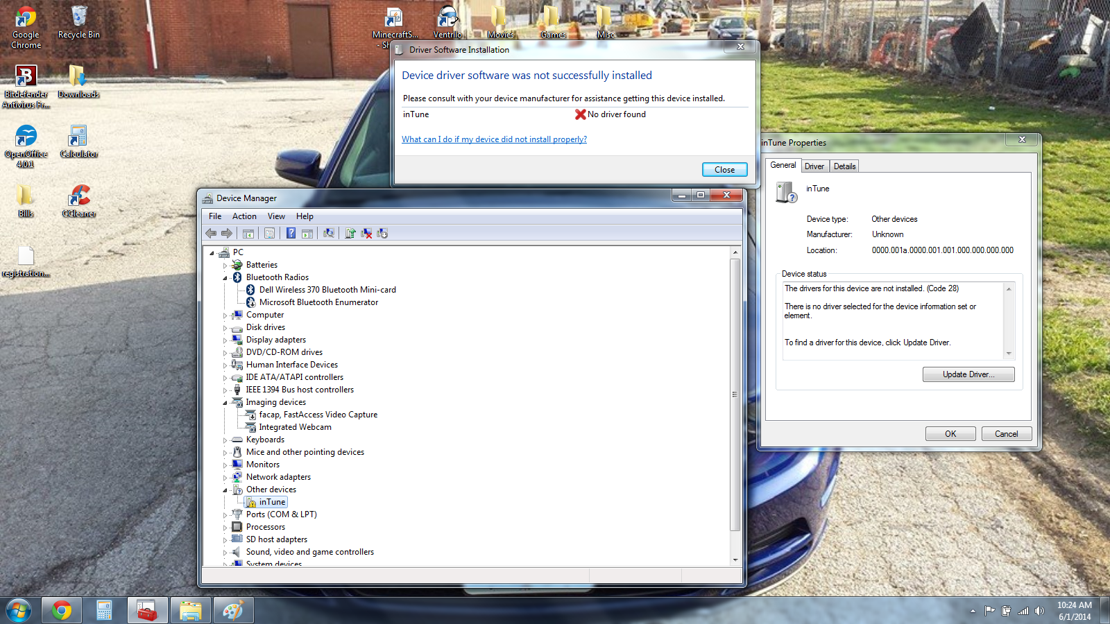

I've plugged this into 2 other laptop neither of which I owned and the tuner drive loaded just fine. However my problem comes when I try to use it on my laptop. It will not recognize the USB to install onto my computer. I can't just hijack random laptops when I need to use this thing. Here are a few pictures that show what I'm seeing. Thanks

I understand that...In my pictures that I have attached that is with the device plugged in. No drive presents itself when plugged in.

I figured I would just try the run command and type in intune.exe, no dice...I'm pretty knowledgeable with computers and I've been stonewalled at every attempt. There is no cd drive popping up....there is nothing on my computer that shows that the intune is plugged in other than the "intune device" with a question mark by it in the device manager under "other devices" And the fact that its powered up.
For what its worth its a Windows 7 machine that's fully updated. Also like I stated its worked the first try on both of the other machines I've plugged it into immediately. I've searched the forums and there has been others with this issue but I could never find out what or how it was resolved.
