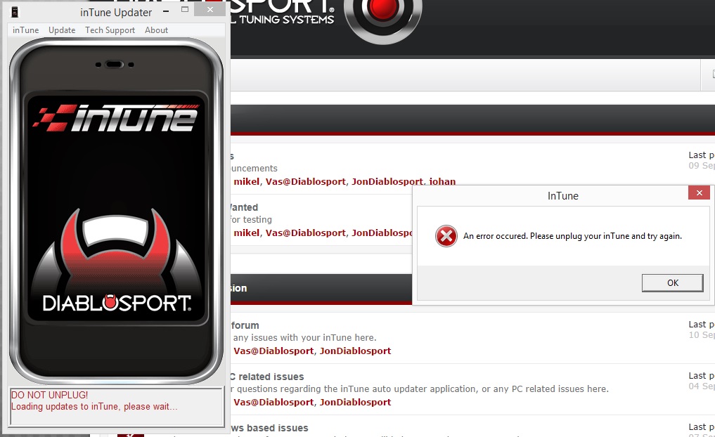

I keep getting this same error when trying to update my intune. I got the error the first time I tried updating it, which was a few months ago. I bought another one last week and I was able to update it yesterday just fine with no problems. However, the original one I am still getting the same error. It just starts the update process and after about 5 minutes it pops up with this error. If I unplug it and try updating again I will get the same error. I have tried restarting my computer and doing all of the normal things with no solution. Also, the fact that I was able to update the other one tells me there's something wrong with this particular programmer.

put this on the intune drive,. let it reboot, then run the updater again.
cdrom-1r01s.itf
