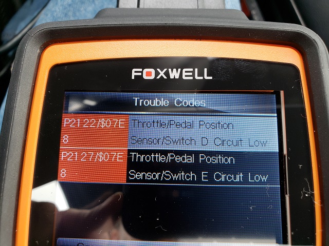

Yesterday things went horribly wrong. As I was leaving work, the system spazzed out again. This time though when I stepped on the throttle there was zero response. I could floor it and the truck didn't care. It did want to accelerate on it's own - up to about 56MPH. The only way to control it was to stand on the brakes or to shift to neutral and let it slow down naturally. I pulled over, disconnected the battery, removed the Pulsar, reconnected the battery, cleared the codes and then proceeded to drive for over 4 hours without any incidents. I *did* take some pictures for you which should be helpful. I've got one of the dash showing 4 errors, and then 2 of the scan tool (with TPS error).
At this point I honestly do not feel comfortable putting the Pulsar back into my truck. I can't be put into a position where the truck takes off on it's own and I have no control.
- scan tool 2
- 20190122_142500.jpg (141.62 KiB) Viewed 8806 times
- scan tool 1
- 20190122_142428.jpg (107.41 KiB) Viewed 8806 times
