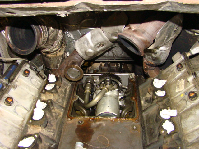

here are the pictures of the block off plates, you can see the round plate that is installed that will block the entrance and the oval shaped plate that will block the exit side.
- DSC00094.JPG (96.02 KiB) Viewed 2008 times
- DSC00095.JPG (120.71 KiB) Viewed 2008 times
