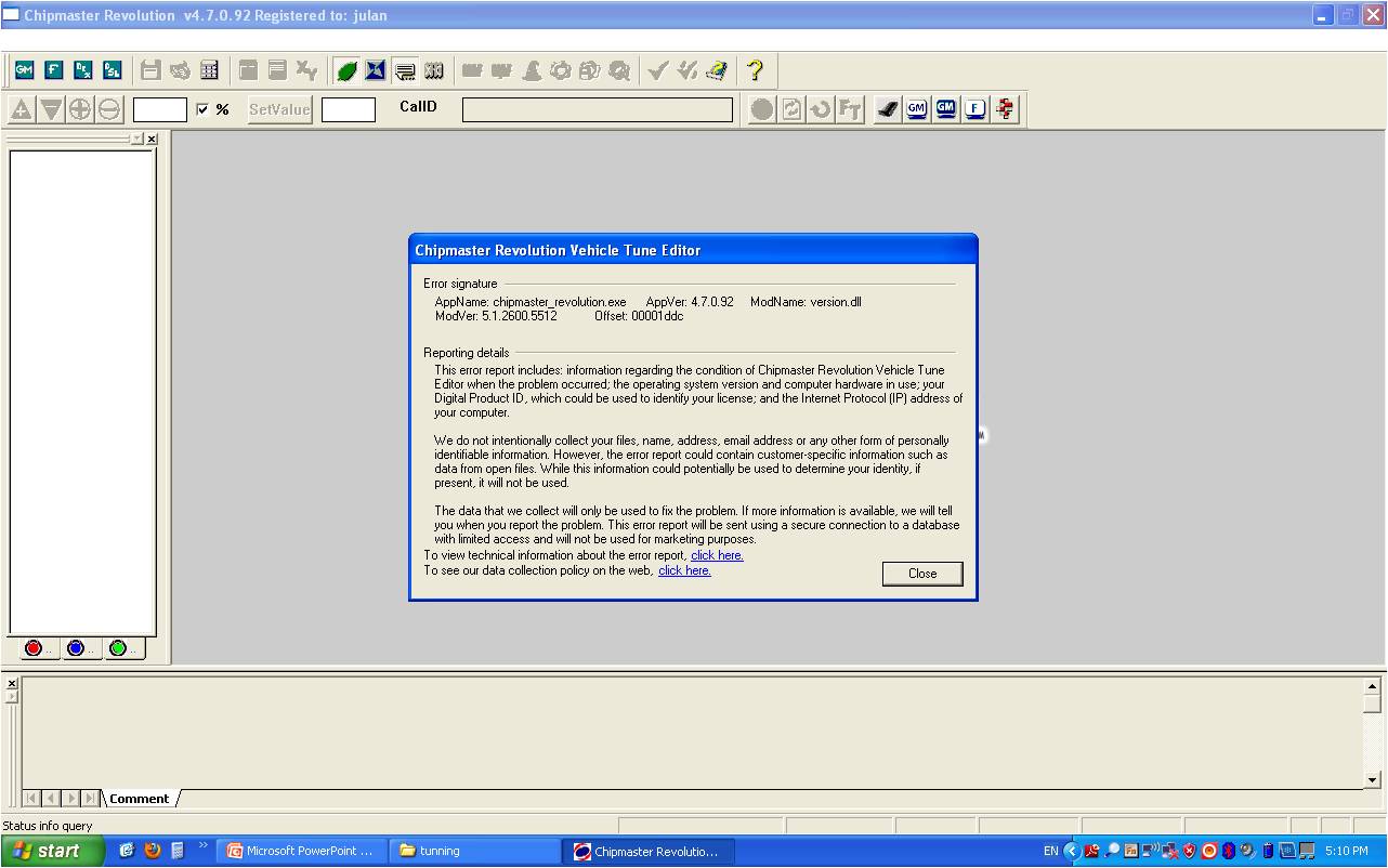

Hi,
I get the attached error every time I access CMR software, I re-installed the software with no luck, the same error keeps appearing.
thanks

I get it on v4.8.0.0 also. Try the following:
Open Windows Explorer to C:\Chipmaster Revolution.
Launch Chipmaster_Revolution_4.4.7.1.exe (double mouse click).
It will post a dialouge of Not Registered, etc, etc. Just login with your CMR credentials (login/password).
Restart CMR version 4.7.0.9.2. It should now run.

RE: Error every time I access CMR software
Post by julan »
thx that worked fine for me

I get the same error and did what JIM said and it still doesn't work any ideas?

Assuming you have 4.7.0.9.2 and recent version of DSDL installed. Try installing the 4.8.0.8 update found in http://www.diablosport.com/index.php?mo ... 2&cmr=soft
Be sure to install in same C:\Chipmaster Revolution folder as 4.7.0.92. Running 4.8.0.8 may have a pop-up indicating Burner file missing, just select OK.

jimb wrote:Assuming you have 4.7.0.9.2 and recent version of DSDL installed. Try installing the 4.8.0.8 update found in http://www.diablosport.com/index.php?mo ... 2&cmr=soft
That seemed to work! THANKS
This happened after it downloaded some updates then all of a sudden ChipmasterRev got that error. How do I know if the DSDL version is recent?

DSDL will indicate if a new rev is available. The current rev is 2.2.2.4.
