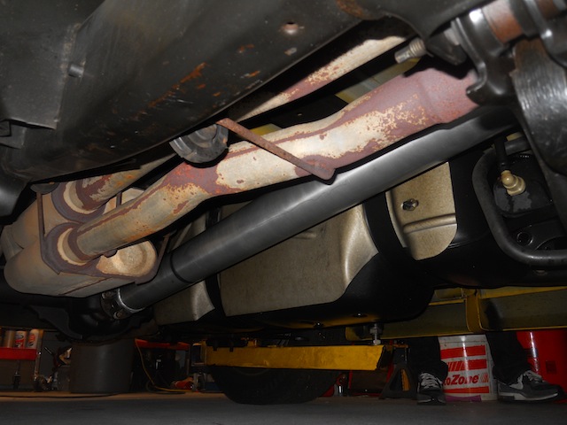

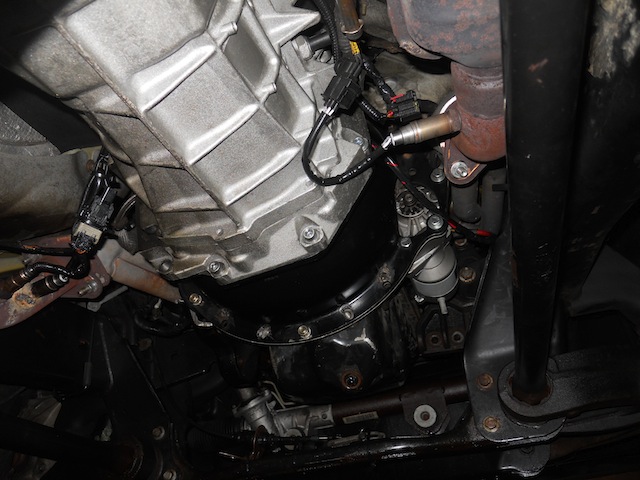

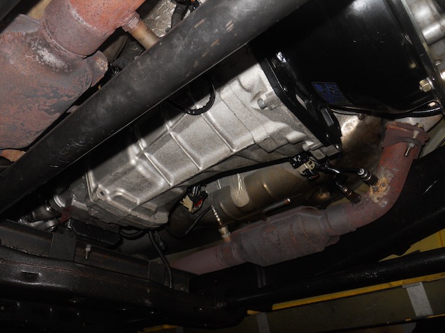

dabramwski
Posts: 8
Joined: Mon Apr 04, 2011 8:33 pm
RE: Manual transmission installed 2005 ram
Post by dabramwski »
Heres some pics

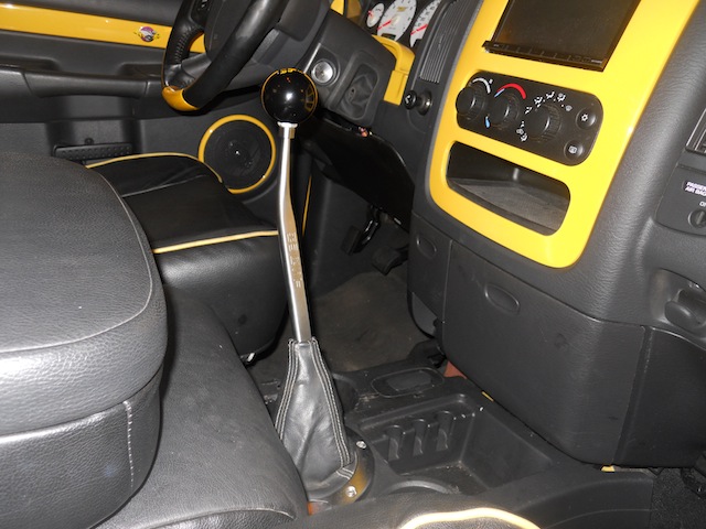

Very nice setup. For the peddels did you just use a set of factory units from a 3500 with a manual? Did they bolt right in or was there any fabrication required? Lastly, the shift lever... is it a custom peice or did you use an off the shelf item?

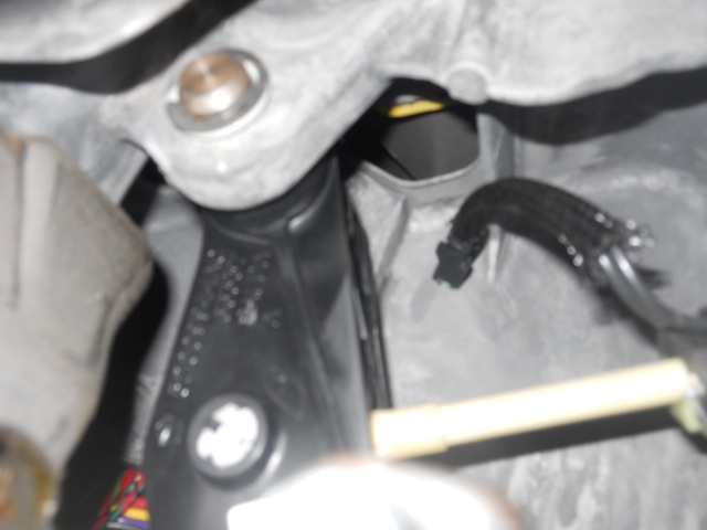

Do you recommend anyone to do a flash on the PCM I am on long island NY ? Also will be looking for tuning for a supercharged 392 soon if anyone can point me in the right direction. Pedals were just bolt in i used setup out of a 2005 srt 10 ram all u need is the the clutch pedal a new smaller break pedal a pin some bushings and a c clip and your in business the bracket that under the dash is already setup for a clutch pedal shifter is also out of a 2005 dodge ram srt 10 as well found it on eBay because the dealer wanted an arm and a leg for it If i can find my slip from the dealer i will post part numbers on pedal setup.
dabramwski
Posts: 8
ok so the clutch cylinder is bolt right up might and comes with hose and all part # 5037431aa it cost me $240, you will need 4 bushings part # 52010309ab cost me $2.08, 1 shaft pin part # 52010318aa cost me $2.53 a snap ring to hold it in part # 6023879 cost me $2.07, a clutch pin to link cylinder to pedal part # 52010331ac cost me $2.59, clutch and brake pedals dont remember which was which part # 52009944ac $28.00 and 52010221ac $25.07 and also i have part # for pilot i used 53009180ab $21.68 and shift lever 5037436ab 109.94 Tried to take a picture under dash to give you an idea.
