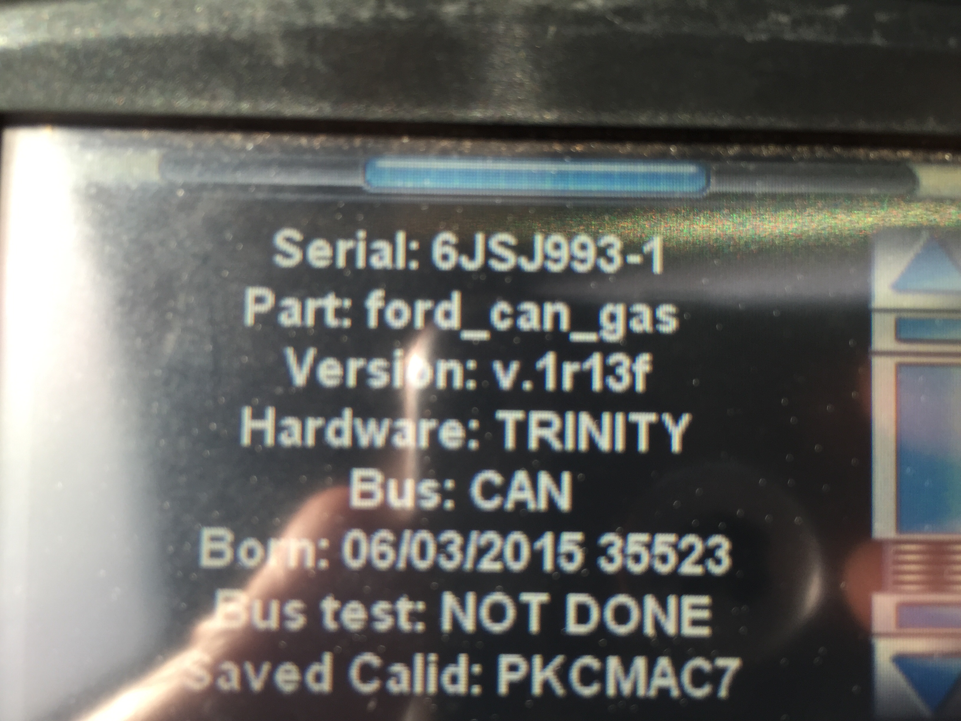

heath t wrote:Im having part throttle surge issues. Its very bad. WOT feels fine, but between 1/4-1/2 throttle, the truck spits and sputters badly.
Which tune? Please go to options -> show information and get me the verion # off the tool
Also post your last tune written and original backup. If you have any datalogs that is also helpful.

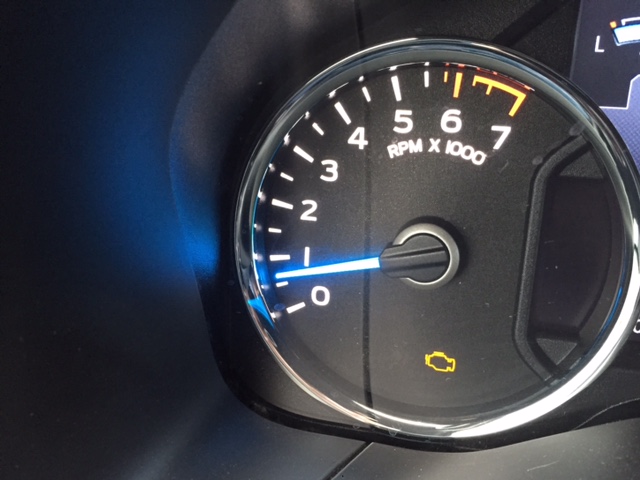

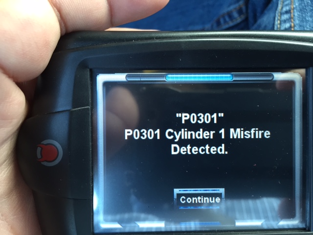

i feel very upset, i´m still having issues with the 93 performance tune, after 10-15 minutes i lost all throttle , a check engine lamp pop up , i restore to original back up and lamp still on it feels like a spark plug is failing , i used the tool for diagnostic and it says misfire in cylinder 1 and it still feel very shaky engine with the stock tune ( original file ) at the time to restore it to original tune , the tool frozen with the wait screen 40 minutes

juangorena wrote:i feel very upset, i´m still having issues with the 93 performance tune, after 10-15 minutes i lost all throttle , a check engine lamp pop up , i restore to original back up and lamp still on it feels like a spark plug is failing , i used the tool for diagnostic and it says misfire in cylinder 1 and it still feel very shaky engine with the stock tune ( original file ) at the time to restore it to original tune , the tool frozen with the wait screen 40 minutes
Have you updated to the latest test crom in this thread?
