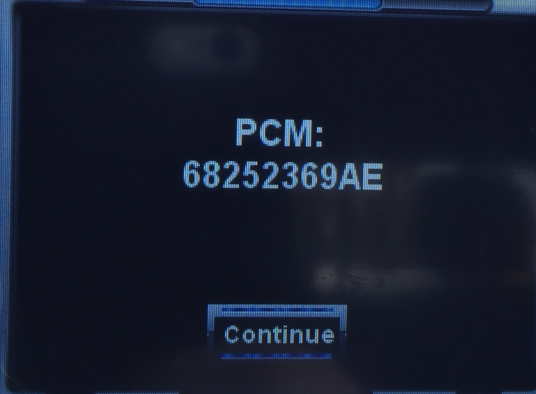

mikel wrote:options/troubleshooting/show calid, what do you get?
Is this when the Trinity is connected to my truck or pc? I don't recall getting any options while it was connected to my truck. It just prompted me to recalibrate via the DSDownloader.
I know what you mean now. Ill reconnect it to my truck and let you know.
ssmithcpd
Posts: 22
Joined: Thu Feb 04, 2016 5:37 pm
Re: DiabloSport Server Down?
Post by ssmithcpd »
This is the info I received..
