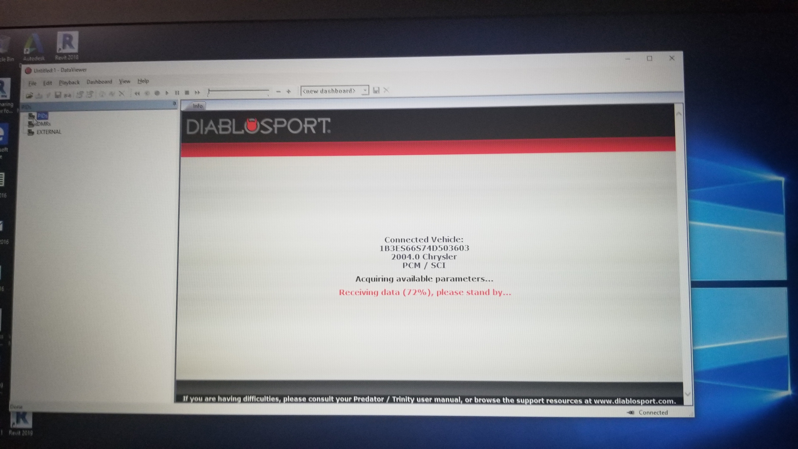

I have the original predator, I have no problems downloading and installing tunes. I can also log with the predator as well. However, when I open the data and try to record live data it doesn't work. First I have to click on "reconnect to tool", then the screen says, " acquiring vehicle information". This takes about 3 to 5 minutes while it starts at 1% and slowly climbs to 100%. After this ,still no luck. I try to expand the "PID" tree but it wont allow me to expand it. The only thing I'm able to do is download a log from the handheld and view it that way. I've tried a new cable, and three different laptops all with the same result. Any ideas???

Has anyone found a fix to this issue, mine is doing the same thing

uninstall dv then try installing this one.
DataViewer_3.3.0.15.exe
(19.58 MiB) Downloaded 558 times

that solved it, thanks for the fast response and support :D
