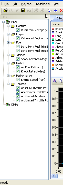

CPM Retard? this is the only one that i see with % deg not count.. I tried to log this one but did not get any hits, just 0%.. not sure what that one is? I have max kr on the handheld but I dont see the same on laptop.. Thanks

Redgto04
Posts: 83
Joined: Sat Jul 12, 2008 9:31 am
Post by Redgto04 »
Under pid's, misfire folder, Knock retard!
