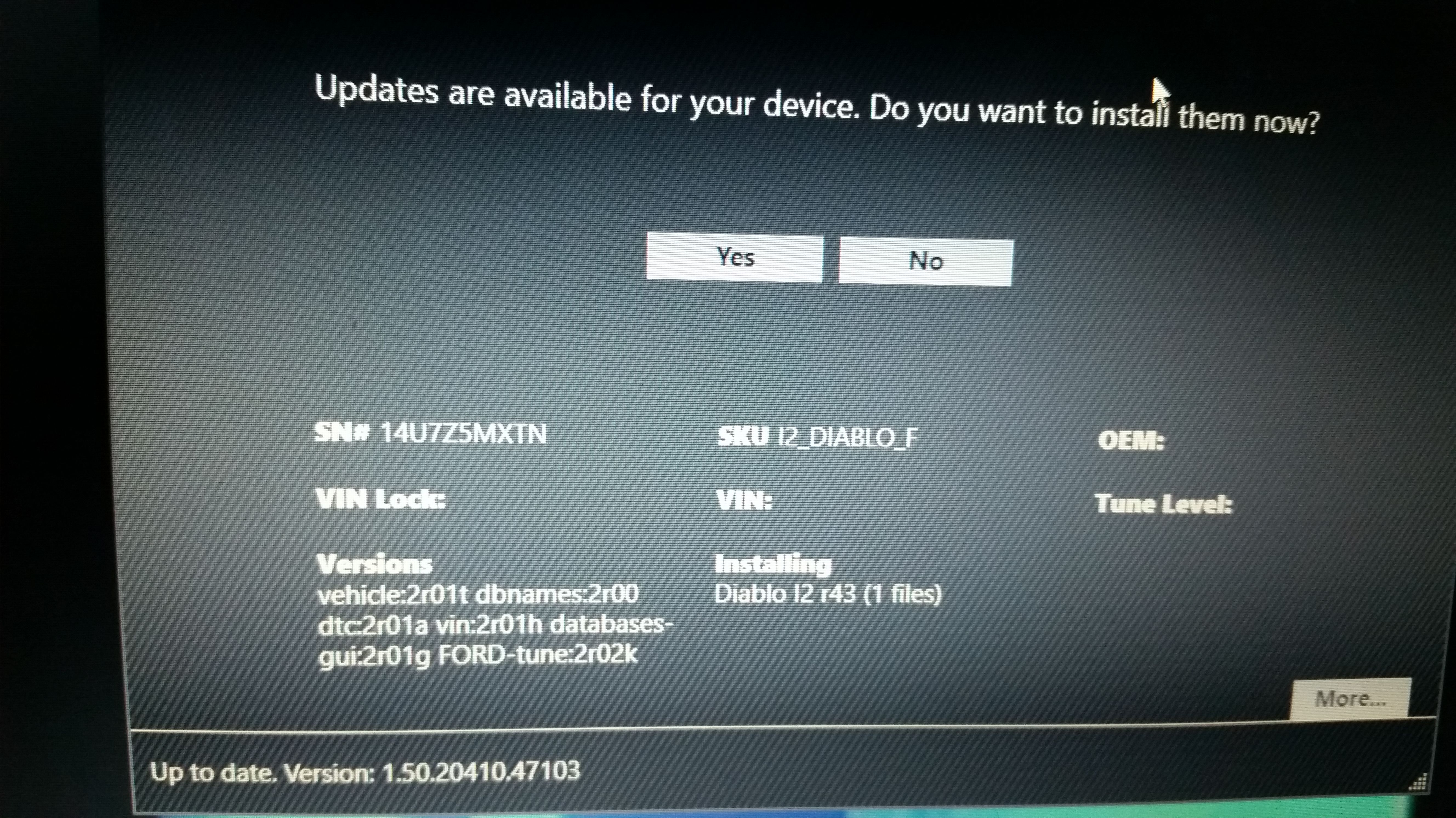

Everytime I plug into windows computer and open the ignition software it says I need an update. Flies through a couple screens then says you can either purchase more licenses or unplug you are up to date. Then when I plug back in it just keep repeating like its not updating. Not sure if I am missing something but here are a couple screenshots. And no matter how many times I try to go through the link to activate the wifi on my intune 2020 on the ignition program I fill out the form but it never sends the wifi unlock to device? Unless there is something else to do for that as well? Thanks in advance I have had this for over week now and finaly get a free time to call in for support to find out they are closed today grrr...

I should also add when I first tried to do the update brand new out of the box thing it was on a mac. Wasn't getting anywhere with that so I switched over to windows 10 laptop. If it is somthing as simple as a factory reset on the unit but even at that where to even start...

Or if anyone happens on this post could double check your info on yours to see if everything is actually updated? Everytime i plug it in it tries to grab 1 file for update goes hrough the process and then bam doesnt actually install that file. something update_0.

Well talked to tech support was assured my unit is all up to date. Thumbs up there and loaded a tune seems to work, pretty noticeable difference 87 octane. Was told I needed some kit as well for the wifi to work along with some kind of software update when I install the barrels to the lines, now if yours did nothing and wifi still don't work then it doesn't give me much hope mine will be a smooth transition. But so far so good with everything else will keep this updated for the near future on my results.

Just because I hate to start a topic and have no conclusion. All is well, diablo tech added my s/n to the database plugged into ignition and pulled in the update for the wifi. Everything now works. Fwiw once I reached out for help diablo had all my issues resolved within 2 days can't complain about that, thanks much!!
