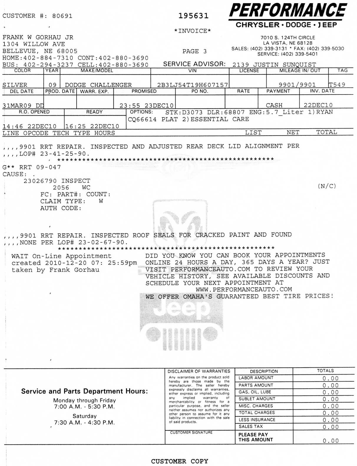

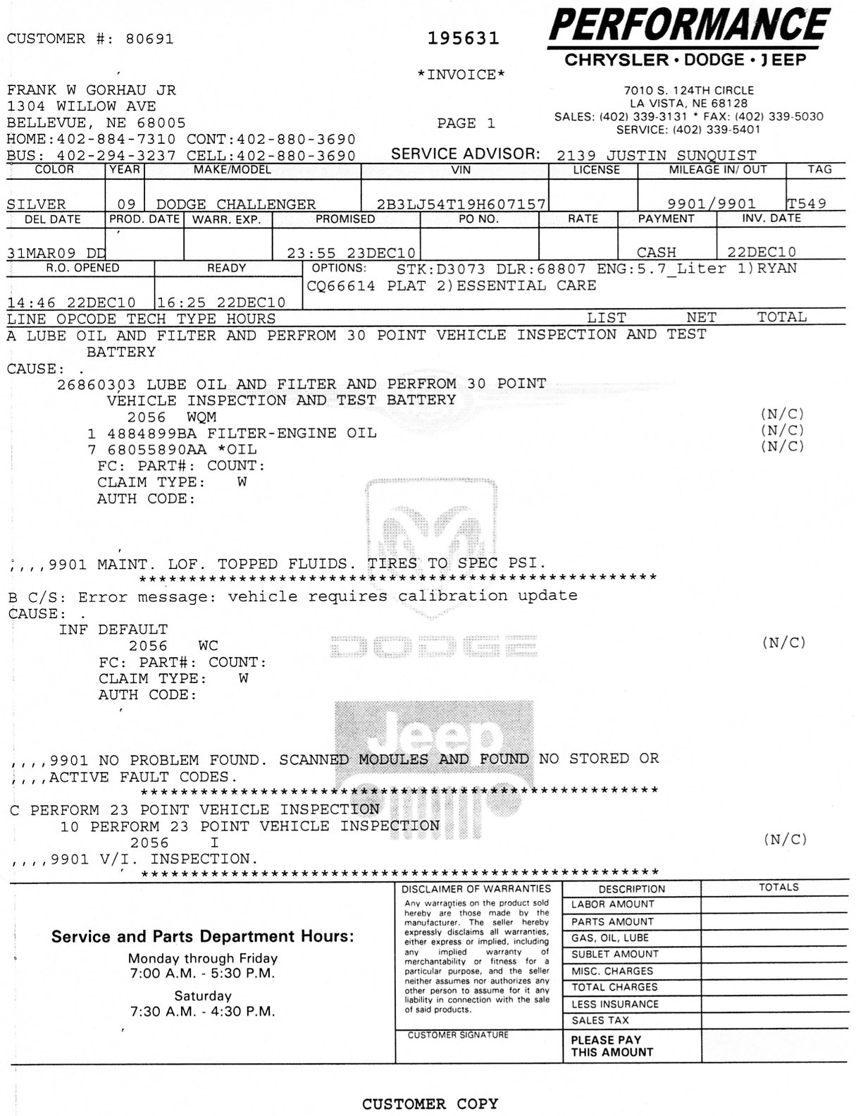

This Vehicle Needs an Update Download Here...
Here are the documents the dealer gave me... the re-flash is on page 2
Thanks, and I'll be calling right after I send these...
Frank
Frank

RE: This Vehicle Needs an Update Download Here...
Apologies to all... didn't know these images would post super-sized...
I tried the E-mail again, and it appears to have gone through this time...
